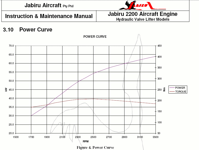

Guest browng Posted November 13, 2007 Posted November 13, 2007 George, have you view the videos of this engine? The cam assemblies appear to be pretty big so no flywheel is required. Unfortunately I can't view videos at work, bloody IT dpt, but I would be very interested in an rpm/torque comparison with a 4cyl Jabiru. the Revetec X4 claims' "125Nm@2,000rpm, peaked at 140Nm@3,700rpm and maintained 115Nm@4,700rpm" Does anybody have the Jabiru torque numbers handy? Their website doesn't seem to quote them.
slartibartfast Posted November 13, 2007 Posted November 13, 2007 2200 Power Curve [ATTACH]4260.vB[/ATTACH] Here's the power curve from the manual.

Guest browng Posted November 13, 2007 Posted November 13, 2007 [ATTACH]3741[/ATTACH]Here's the power curve from the manual. On that data the Revetec seems very low on torque compared to the Jabiru, it produces less continuous torque at higher revs, i.e. 115Nm@4,700rpm as compared to almost 200Nm at 2500rpm for the Jabiru. The Jabiru drops off at higher revs, but not by a significant amount, and even at peak revs the X4 only produces 140Nm. On those figures it would seem to be more of a competitor to the 2-strokes than the 4-strokes.

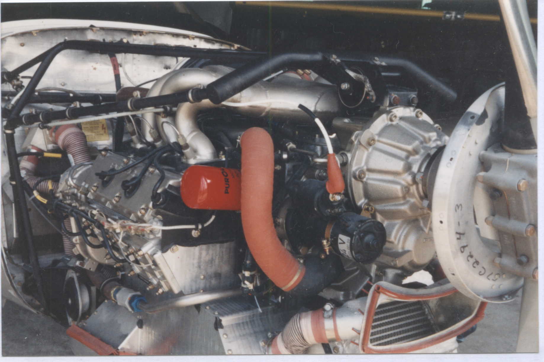

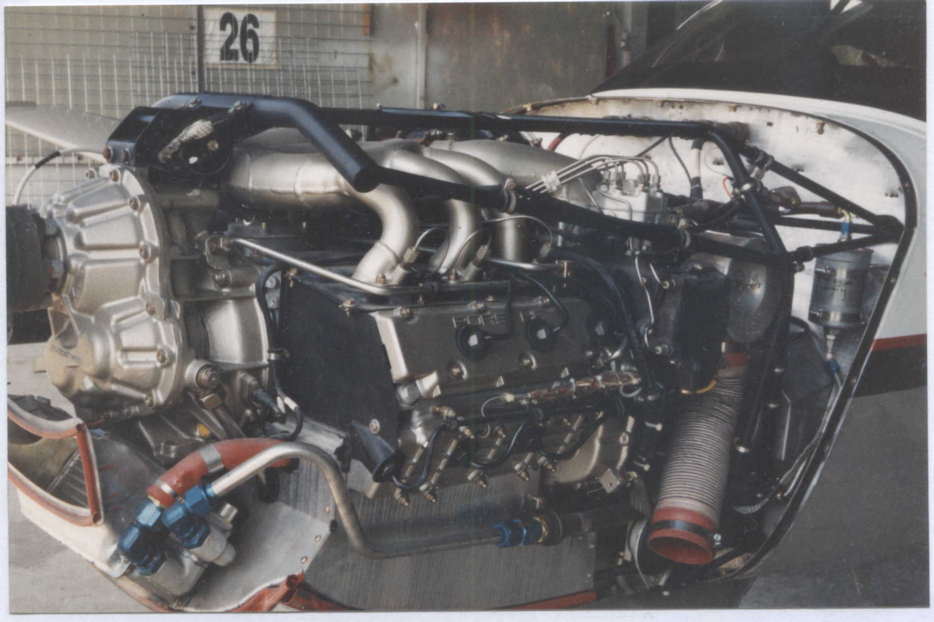

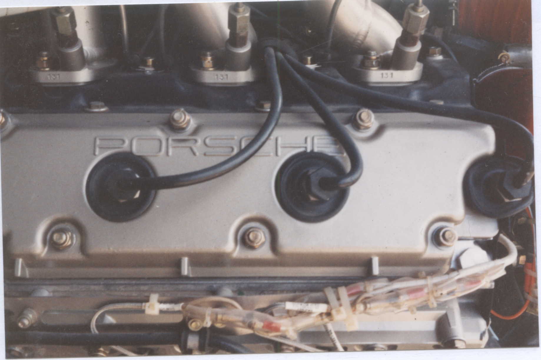

Yenn Posted November 13, 2007 Posted November 13, 2007 If my memory serves me correctly the Mooney, Porsche plane was pretty good but as maintenance came up on the motor, Porsche said they would replace it with one of the conventional engines "can't remember which" and take the Porsche out of service. I don't think there was any great problem but Porsche had had enough.
Guest browng Posted November 13, 2007 Posted November 13, 2007 If my memory serves me correctly the Mooney, Porsche plane was pretty good but as maintenance came up on the motor, Porsche said they would replace it with one of the conventional engines "can't remember which" and take the Porsche out of service.I don't think there was any great problem but Porsche had had enough. The problem was weight, the Porche engine was very heavy, but the engine weight was not the only problem, the PFM required complicated ancillaries as well. The Mooney Porsche was about two hundred pounds heavier than the Mooney 201. The installation was also bulky with a fairing drag penalty, all in all it was a bit of a disaster. Ironically, to get the performance that they had sold the buyers, Mooney replaced the PFM with the turbocharged Lycoming TIO-540, which was only slightly lighter, but produced more power.

Guest ozzie Posted November 13, 2007 Posted November 13, 2007 Ah, the PFM Interesting engine. had the chance to work on one years ago. the actual engine is sound. it was the nightmare electrical system and electronics that would be the source of most problems. from memory ,2 batteries 2 alternators 4 cdi units, 1992 electronics driving ign fuel and prop. once you move away from magnetos redundency becomes complicated. this mooney came in for an AD on the gearbox casing and a 100hrly. ozzie
