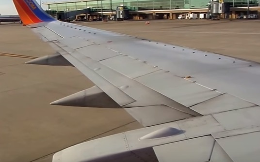

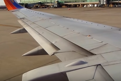

kasper Posted August 26, 2016 Posted August 26, 2016 Take a look at at the trailing edge and ask where are the flaps?
facthunter Posted August 26, 2016 Posted August 26, 2016 I did that and they are not UP. The Leading edge devices are extended . You can see that early in the take off roll. I'd say the flaps are at least 5 degrees. Nev 1
facthunter Posted August 26, 2016 Posted August 26, 2016 Don't think the setting was changed. It still looks the same. Nev
M61A1 Posted August 26, 2016 Posted August 26, 2016 I don't think there's much in it looking at it from the rear....Initially I thought the flaps were still up, but when you see what it looks like up, you can see the difference. Stills from a youtube clip just before pushback. Flaps up... and set for t/o?

pylon500 Posted August 31, 2016 Posted August 31, 2016 Doesn't look like a lot of flap, I thought they only had a limited number of positions? Either way, he probably should have had the next one? Was lucky he had the room to set down and get a bit more speed. Also, if the camera was in the same spot, he was taking off opposite the Airbus that landed first?
dutchroll Posted September 1, 2016 Posted September 1, 2016 Definitely rotated way early compared to a "normal" takeoff. If you compare the time to the first attempt to rotate to any of the numerous other B737 takeoff videos out there, there's a very big difference. The flaps look like they are at "1" (leading edge flaps/slats partly extended, trailing edge flaps retracted) which is a valid takeoff position. Why did they rotate so early? No idea. Mistook the "V1" call for the "rotate" call maybe?

pylon500 Posted September 3, 2016 Posted September 3, 2016 The flaps look like they are at "1" (leading edge flaps/slats partly extended, trailing edge flaps retracted) which is a valid takeoff position. I thought 'Flaps 1' was more a climb-out position, with at least one stage of trailing edge (if not two?) flap for heavy take off and initial climb (below 1000')?
dutchroll Posted September 3, 2016 Posted September 3, 2016 On the B737, takeoff with flaps 1 improves the second segment climb performance. What this means is that on certain runways where second segment climb performance is limiting due to obstacles and required climb out gradients but the runway length is sufficient, the takeoff weight can be increased by using flaps 1. On our B737s using runway 35 at Canberra for example, where the second segment is limiting due to the gradient required, using flaps 1 for takeoff gives them an extra 2.8 tonnes of payload. It's not a "common" takeoff flap setting for the B737 as such. They usually use flap 5. But it's an "allowable" one which can be used in certain circumstances. They can use more than flap 5 for takeoff too. That would be if the weight and runway length were performance limiting but the second segment was not. On the B767 the standard takeoff setting was flap 5 but at heavy weights and warm days in Honololu or Tokyo we sometimes had to use flap 10.
dutchroll Posted September 3, 2016 Posted September 3, 2016 Sorry, flap 15 on the B767 for runway length/weight limitations. There was no flap 10 setting. Getting confused with my even earlier years on the B747 which does have a flap 10 setting but normally used flap 20 for takeoff. It still looks like they rotated too early even if they had V speeds for the wrong flap setting. The difference is < 10 knots and usually more like 3-4.
