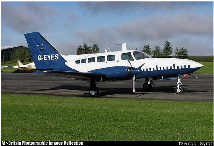

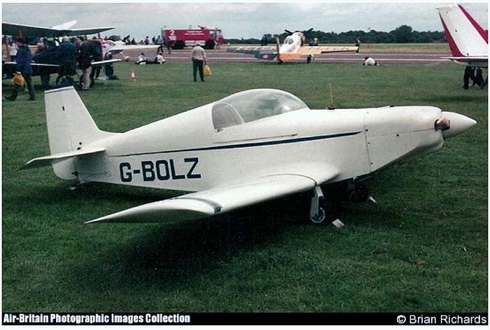

Garfly Posted September 10, 2016 Posted September 10, 2016 The collision near Coventry airport in 2008, killing five, also shows that even having a tower is no guarantee: https://assets.publishing.service.gov.uk/media/5422f6dd40f0b613420005b1/8-2010_G-BOLZ_G-EYES.pdf

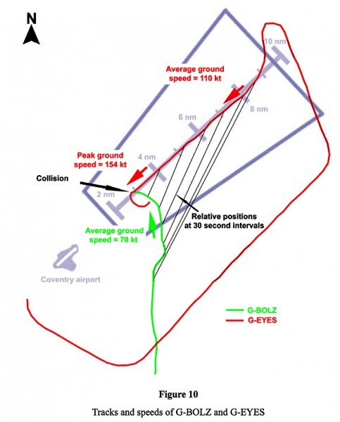

onetrack Posted September 11, 2016 Posted September 11, 2016 Garfly, in the G-EYES/G-BOLZ collision, it appears not only were there ATC failures, but it's highly likely the pilot of G-BOLZ was under the impression that G-EYES was carrying out a normal landing, instead of high-speed GA's involving instrument calibration, so he probably would have dismissed G-EYES as a collision threat, fully expecting G-EYES to be on the runway within a very short time. The angle of approach of G-EYES to G-BOLZ is described as "likely to have been visible behind the trailing edge of G-BOLZ’s right wing." To sight G-EYES, the pilot of G-BOLZ would have had to rotate his head more than 90 degrees. Table 4 in the report indicates the possible approach angle of G-EYES to G-BOLZ was 121 degrees (to the right), shortly before impact. In addition, converging objects, even when travelling at substantially differing speeds, often appear to produce no relative movement, thus becoming virtually invisible to someone looking out for a moving object. Finally, there is that curious human factor called "inattentional blindness". One looks, the eyes see, but the brain does not register the object seen. In my personal observations, I believe IB becomes a more common problem, as one ages. Once you are aware of the possibility of IB, you can train yourself to be more cautious, and increase the amount of checking that you do. 1

Garfly Posted September 11, 2016 Posted September 11, 2016 Onetrack, yes, I agree, the fatal factor at Coventry seems to have been the unusually high speed of the C402 on final (due to its ILS calibration task). This crucial (out-of-the-ordinary) fact was not grasped by the controller who'd come on shift. Anyway, as far as I can read, the outcome had little connection with what the pilot of G-BOLZ did or didn't do and nothing whatever to do with his age. He was, after all, following the direction of the Aerodrome Controller, sequenced #2 to follow the PA28. In fact, he was never directly informed of the C402 established on the ILS although he would have heard the controller tell some aircraft (G-EYES) to follow him as #3. So he was entitled to assume that his right flank was more or less protected and that it was his job to make sure the landing PA28 (#1) was in sight and well clear. Of course, he should've - probably would've - instinctively 'cleared-right' visually, at least prior to turning final but, then, it never came to that. Before the turn he was directed to fly on through finals since the controller realised that his sequence plan wasn't working out. Too late, too late. If an "Inattentional Blindness" issue arose, here, it might have been more with the 402 crew although the report says that the small G-BOLZ was probably hidden from the view of the Cessna's lookout pilot by the central windscreen pillar. It's also mentioned that since they were on an IFR plan, that crew's expectation might have been assured protection from VFR circuit traffic. This, though, was not technically/legally true since the whole thing was actually happening in G airspace. (As far as I know, this contradiction: tower 'control' in 'uncontrolled' airspace does not arise in Australia, at all. But then, if the UK had our system, there'd probably be precious little G airspace available there at all.) Anyway, much to learn from this tragedy, for which, it seems, no individual was clearly to blame. For me, one lesson is to keep one's head moving around fixed obstructions checking for the worst of threats - the hidden and/or unmoving ones. Another lesson: when doing anything in the air other-than-might-be-expected, especially near airports, let others know so they can be on guard against normal (false) assumptions. But there's nothing in this report that warns me against getting old(er), especially. Still it's true (G.B.Shaw said it first, I think) that whereas recreational flying is the most wonderful thing in the world, it's a shame that it's wasted on the old. BTW: I note that the first commenters on Kathryn's Report (Post #37 above) jumping in about the West Georgia accident were quick to blame the oldness of the old guy. Never mind the rules of evidence ... nor defamation. 1 1
onetrack Posted September 12, 2016 Posted September 12, 2016 So he was entitled to assume that his right flank was more or less protected And right there is the crux of the problem. I have had it drilled into me, "Never ASSUME anything - because it makes an ASS out of U and ME."The final responsibility is on the PIC to avoid MAC's. ATC can only do so much. The statistical MAC figures are clear - only 14% of MAC's occur as head-ons, 39% occur as side-ons with converging aircraft, and a whopping 47% occur as one aircraft overtakes another. Another factor in the MAC between G-BOLZ and G-EYES was that the pilot of G-BOLZ had only flown 3 times in the previous 12 mths. You keep up to speed by getting out there regularly, and practising keeping familiar with the demands and intricacies of the tasks of flying. Plenty of good and important advice here - https://www.aopa.org/-/media/Files/AOPA/Home/Pilot-Resources/ASI/Safety-Advisors/sa15.pdf 1
