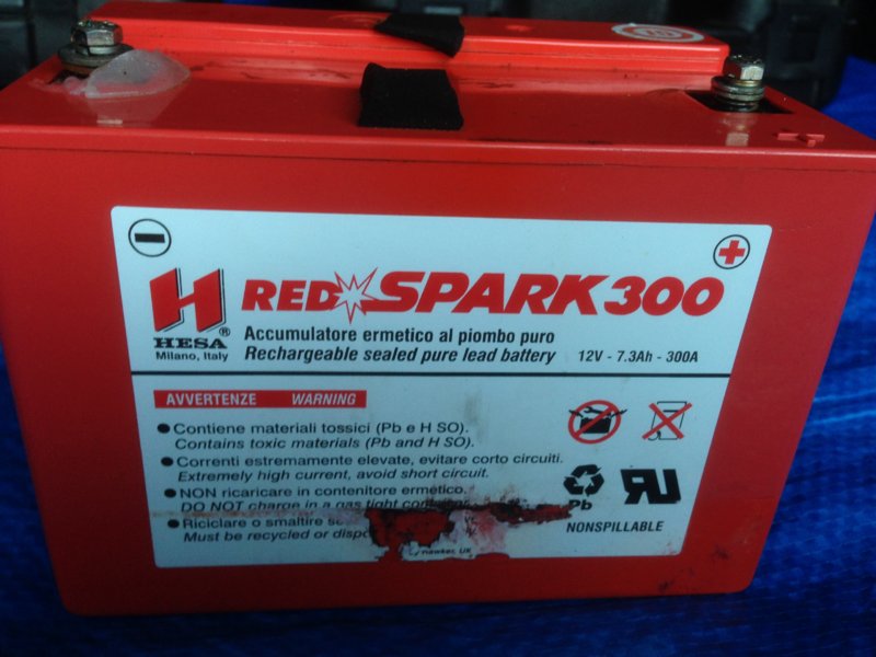

ozzietriker Posted September 15, 2016 Posted September 15, 2016 Hi fellow Aviators, I need to replace my battery. I cannot get this battery here in Australia. Can anyone suggest an effective equivalent make and model to the one pictured? It is fitted to a Magni M16 Gyrocopter, with Rotax 912ULS 100hp - so it would need to be a sealed unit and able to withstand high frequency airframe vibration in flight i.e marine grade. Been to some battery shops in town and they're not helpful. Any info would be appreciated. Cheers Andrew
cscotthendry Posted September 15, 2016 Posted September 15, 2016 Helpful tip #1 Whenever you go to buy something like this, don't tell the retailer it's for an aircraft. Reactions will range from stunned vacant looks, to being ordered out of the shop. But seriously, if you need an exact "to specifications" replacement, best to get the full specs on sizes capacity etc from the manufacturer, then go shopping for the specs rather than "I need a new battery for my gyro".
philipnz Posted September 15, 2016 Posted September 15, 2016 I replaced my battery last year. Just googled the numbers on the old one and a match came up at a regular car/bike battery retailer. Marshall Batteries. It's a standard motorcycle battery. Had to give them an hour to charge it as they only put the chemicals in on sale.
DrZoos Posted September 15, 2016 Posted September 15, 2016 Are you 24 or 19 rego If 19 then lots of 12v 8ah batteries will be fine I just ordered my replacement from BatteriesDirect in sydney also Battery Dr has them BCR-0859-1008 There are a lot cheaper types eg: RM12-9FR not sure on the cranking amps??
Yenn Posted September 16, 2016 Posted September 16, 2016 That looks like an Odyssey in shape and they are used with rotax powered planes. I have found Odyssey to be poorer quality than they imply with their advertising and am using a full rivers battery from Batteries Direct. It is the same as an Odyssey as far as i can see, but I can't say if it is as good or better than Odyssey, but it is half the price. 1
Downunder Posted September 16, 2016 Posted September 16, 2016 OK. I replaced my "chinese" battery for my 912 uls with an ODESSEY. First I matched the weight. (Important) This give me the pc625 battery at 6kg. Then checked the terminal orientation/ size and overall dimensions. (Will the cables reach? Lug hole size?) All good. Purchased from 4wdextreme on ebay. Was the lowest price plus free express delivery. Had it in 2 days. Slight mod to the tray as it was a bit wider but has been great for a couple of years now.
Litespeed Posted September 16, 2016 Posted September 16, 2016 Don't forget to make sure it has the bolt down terminals like the original- not the crappy car type ones that oxidize and cause all manner of grief. If you wish to save some weight you could always look into a lithium polymer battery. All the rage in sportsbikes these days and you would swear it is a empty plastic case. But damn do they have a lot of grunt. Also used in race cars etc. On something like a old Moto Guzzi or BMW twin it saves about 8kg and a heap of space. They also have the added benefit of keeping charge- no flying for six months? no problems it will still have about 98% charge.
Litespeed Posted September 16, 2016 Posted September 16, 2016 Here is the equivalent lithium polymer battery to suit your need of 300 cold cranking amps LFPUQ-9 It weighs 1.7kg total And another at 320 cca and 1.1 kg LH9-B

skippydiesel Posted September 24, 2016 Posted September 24, 2016 I am using a motorcycle SSB Power Sport XR Series battery Part Number RB16CL-B CCA: 385 AMP Hours: 19 Net Weight: 6.60KG Supplied by "All Purpose Batteries" (02) 46483111 - www.ssbpowersport.com.au Check out the web site they have a vast range of battery configuratioins
DrZoos Posted September 25, 2016 Posted September 25, 2016 I am using a motorcycle SSB Power Sport XR Series battery Part Number RB16CL-BCCA: 385 AMP Hours: 19 Net Weight: 6.60KG Supplied by "All Purpose Batteries" (02) 46483111 - www.ssbpowersport.com.au Check out the web site they have a vast range of battery configuratioins Wow 19AH, why so huge??? Dump 10AH and go about 2.8kg 1
skippydiesel Posted September 25, 2016 Posted September 25, 2016 Wow 19AH, why so huge???Dump 10AH and go about 2.8kg Firstly : I am a big believer in plenty of cranking amps. Low amps places damaging stress/elevated temperatures on the starting system. My 912 (100hp) starts from cold without any hesitation but on a warm day can have "vapour lock" which can necessitate additional seconds of fast crank to overcome. Second : This battery is dimensionaly within my aircrafts battery cradle space. Third : Is much lighter & powerful than the original, so I have a win win situation while still maintaining acceptable W&B 1
