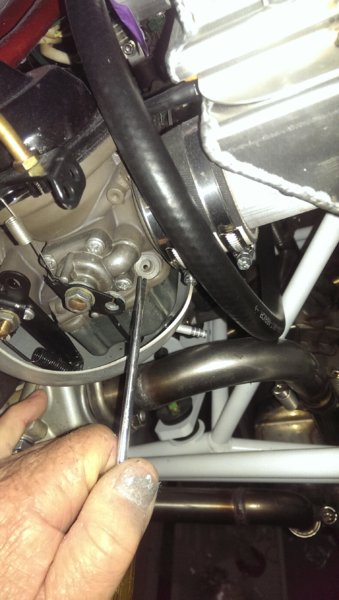

Lyndon Posted September 21, 2016 Author Posted September 21, 2016 Can I confirm it's a m8 x1 thread in the carbs. Lyndon

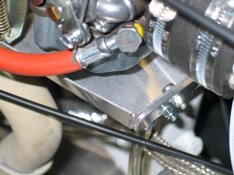

Downunder Posted September 21, 2016 Posted September 21, 2016 Do you have the "clamp block"? The aluminium block that clamps to the air balance tube and divides the fuel lines to each carby. This should have an 8mm bolt you can try. You need to be careful a large body banjo fitting doesn't hit the side of the carby. Spacing it out with washers may work but is a bit "rough". And you lose thread on the bolt. Pulled this pic off the net. Looks like a steel spacer.
crashley Posted September 21, 2016 Posted September 21, 2016 looks to be the right one I wont be at the hangar for a few days so cant confirm thread size but from memory it was an 8mm thread
