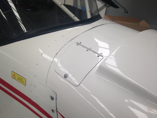

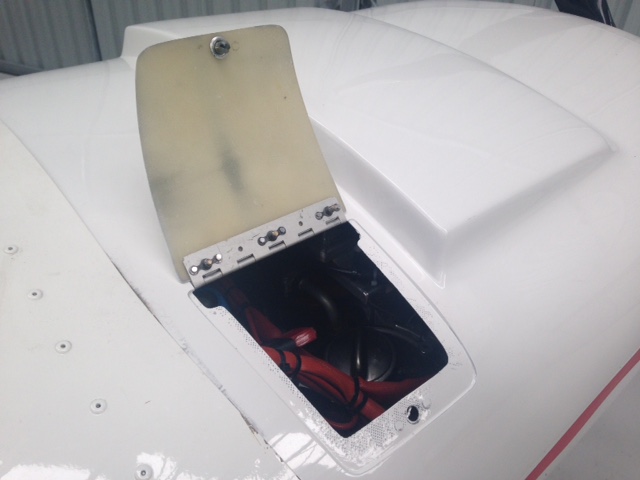

fallowdeer Posted September 20, 2016 Posted September 20, 2016 Hi Trackley Couple pics of the oil level inspection panel we put in my VG. Made pretty much as described in the link above. Very worthwhile and I recommend you do this. Just because you can check oil level easily this way hardly precludes you taking off your cowl as often as you wish for a full inspection in my opinion. Peter
facthunter Posted September 20, 2016 Posted September 20, 2016 You need an inspection cover for the oil level check. It's nice to remove the whole cowl but it really is a pain often needing more than one person to do it without damaging paint etc Plug your intakes with foam like you cover the Pitot to protect it. . One down side is it can be forgotten to fasten or come uncatched and it's usually hinged so as it will flap about. Nev 1
Yenn Posted September 21, 2016 Posted September 21, 2016 Thats an ugly bump on the cowl. I assume it is above the carbies. Would have thought it oould have been faired in a bit better to reduce drag. 1

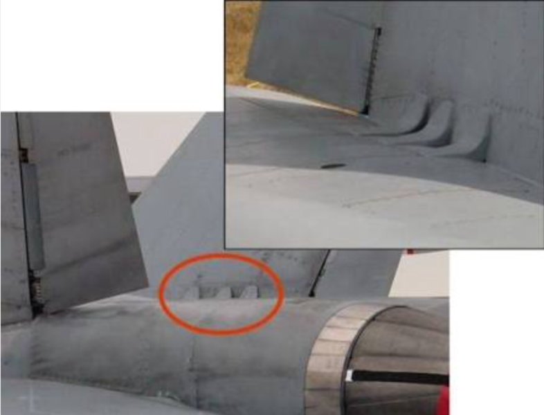

djpacro Posted September 21, 2016 Posted September 21, 2016 Thats an ugly bump on the cowl. Perhaps designed by the same guy who did the F/A-18 fin strengthening .... 1
