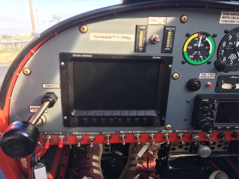

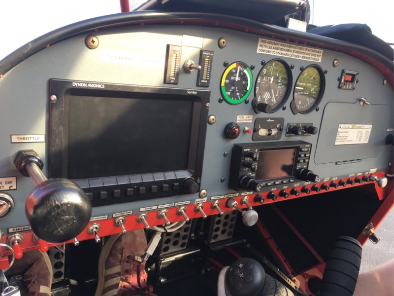

Here are the photos of the Skyview in N5000S for those who asked. Sorry for the delay but I was trying to figure out how to compress them so they could be uploaded...so I asked my teenage son.
