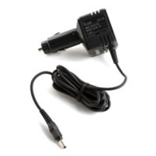

-Rod- Posted October 16, 2016 Posted October 16, 2016 I currently use an Icom A22 as my only radio, without a battery pack, powered via the 12v socket in the side plugged into the aircraft 12v power bus. It seems to work fine.But I have recently read that this is not a good idea, & that a 'battery eliminator' should be used. This is a black box full of electronic trickery, roughly the same size as a battery. The reason I don't have a battery fitted is to save the space it occupies in my very cosy cockpit/panel. So the battery eliminator would negate this. Does anyone else just power their Icom direct from the power bus, without a battery fitted? Any (long term) problems? TIA Bruce ICOM Australia aviation radio dealers sell an ICOM factory cig lighter lead with noise filter (and fuse) designed for the ICOM A20. Some may have units 'on the shelf'. If you want one I have a couple available (we used them on our Drifters at the flying school), on the members market, new but old stock (no Drifters anymore).

merc Posted October 16, 2016 Posted October 16, 2016 Bruce , note that it is a charger for Icom A20 not a 12v power supply
Soleair Posted October 16, 2016 Author Posted October 16, 2016 OK, so perhaps not needed if others have had no problems powering the radio via bus/aircraft battery. I'll leave it as is for now Rod, but thanks for your offer. Cheers
