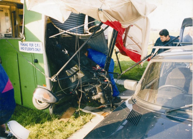

Phil Perry Posted October 14, 2016 Posted October 14, 2016 I regaled you with this story a few years back, but have since been given a photograph. The aircraft was a Pegasus XL, Rotax 447 - 2 seat Trike. The owner 'Handpropped' it, with no wheel chocks nor anyone sitting in the pilot seat. The wreckage revealed that the throttle had been set to full power. The engine started and the aircraft immediately ran away with the owner chasing it. It became airborne approx 100 metres away from the impact point and began a right turn. It lifted off a few metres from a line of parked aircraft and two people had to dive out of it's way. ( The machine had been parked with the right wingtip on the grass, a few metres away from the impact point. ) it climbed to an estimated 70 - 90 feet and as the turn steepened, descended rapidly. It bounced off a car and the trike body entered the Instructors' office doorway coming to rest as shown after turning through 270 degrees from the takeoff heading. One person suffered a broken ankle, he said that a wingtip struck him. two parked cars were also damgaed. This accident was never reported anywhere. There were around 50 - 60 people milling about at the time, so it was nothing short of a miracle that only one person was injured. If you look closely, you can just see a sign, mostly obsured by the roller door, which says 'Chocks must be used when running up aircraft on the ground. - A runaway aircraft is an unforgiveable sin at ths airfield'
