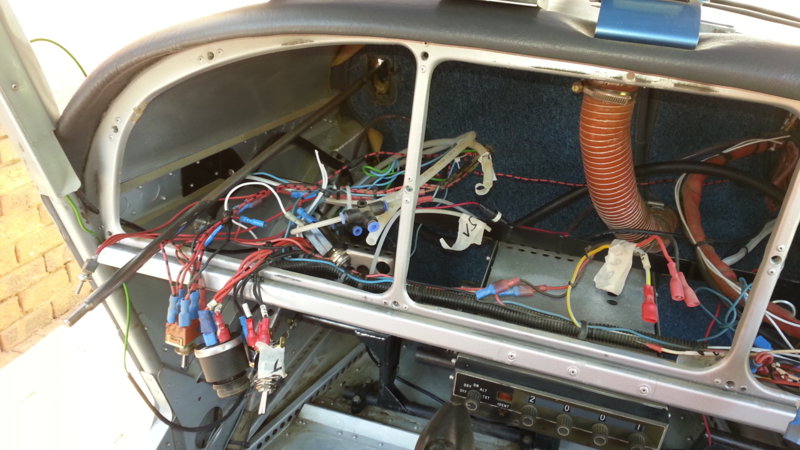

Dash rebuild[ATTACH=full]46391[/ATTACH] [ATTACH=full]46391[/ATTACH]
What is the red air pipe behind the dash?
