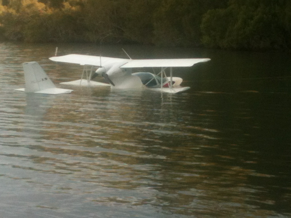

Oscar Posted October 22, 2016 Posted October 22, 2016 The Petrel landing gear retract restraint system is crap; it won't hold fully up under normal manoeuvering loads. However, Petrel's own POH says if there are gear problems, land with gear up on the grass in preference to trying a landing with suspect gear safety on bitumen. You have a better chance of dumping it on the grass, than landing on water if the gear retract system is not working properly - and if the gas strut that is the primary uphold is failing, a less than perfect water landing will break the aircraft and sink it. http://www.16right.com/MessageBoard/Queens%20Lake%20IMG_7520.jpg
