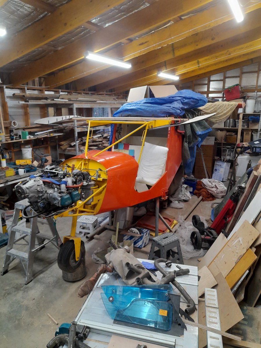

IBob Posted April 21, 2022 Posted April 21, 2022 Great stuff, Marty. Is the cowl going inside or outside of the metalwork?
Marty_d Posted April 21, 2022 Author Posted April 21, 2022 It goes outside, Bob. It's a bit strange in that the upper cowl actually goes inside the lower one, but it just fits better that way. Pleased that the dzus are nice and tight on the 2 layers of cowl, so I guess I'll have to pack out the springs for the ones that go on to the aluminium. 1
Marty_d Posted May 3, 2022 Author Posted May 3, 2022 Cowl is on, held with dzus. I did the "Bob's check pilot" test and yanked side to side on the cowl, it's solid and just moved the whole plane. 3 1

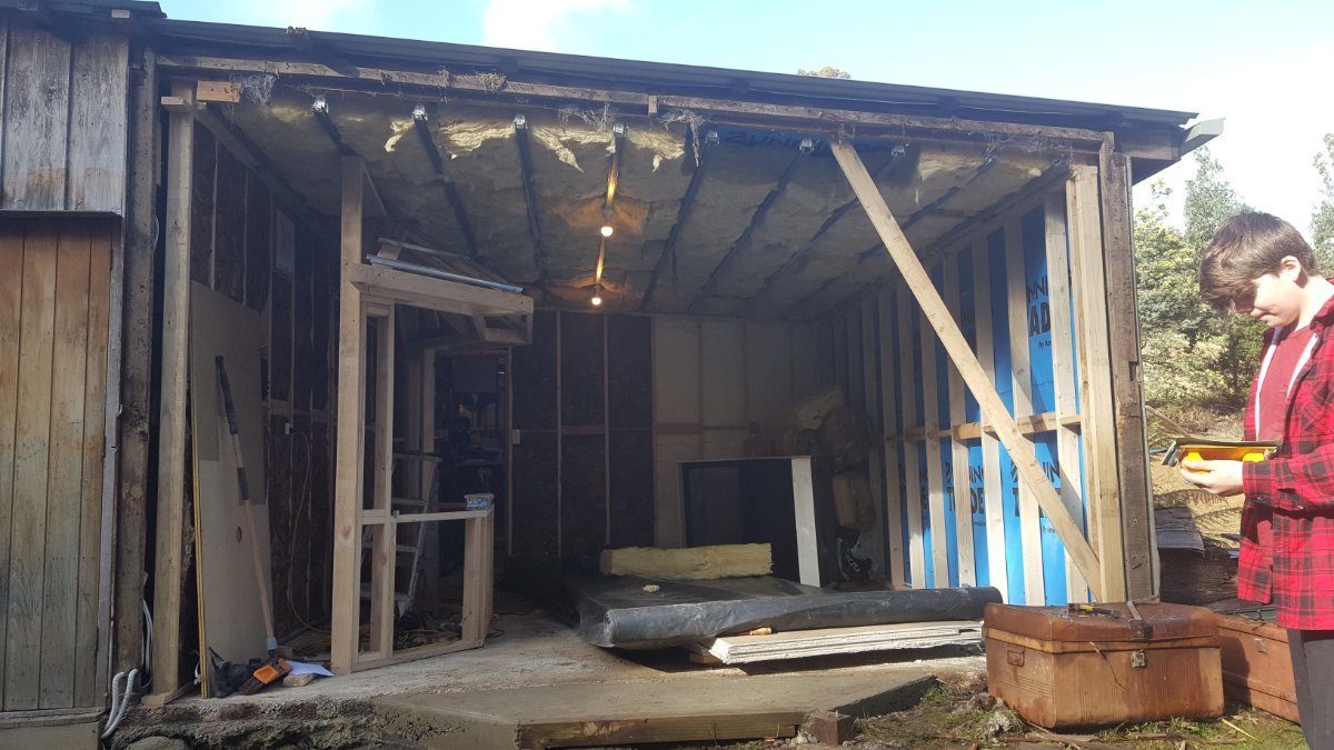

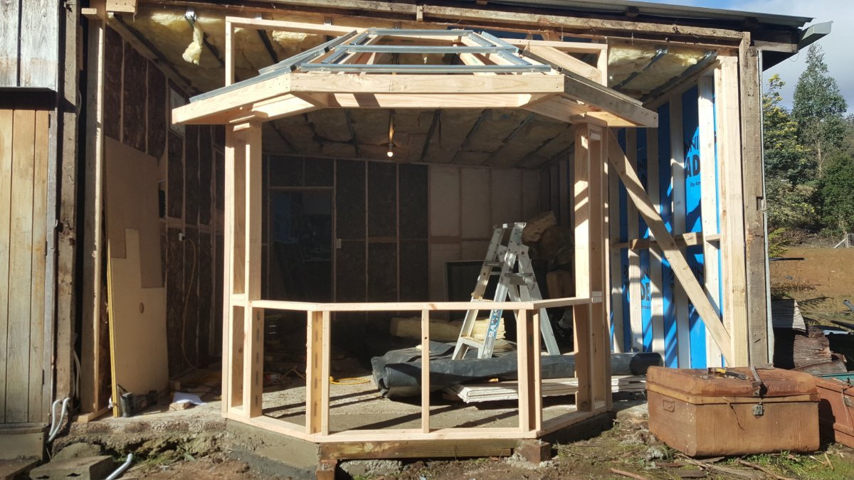

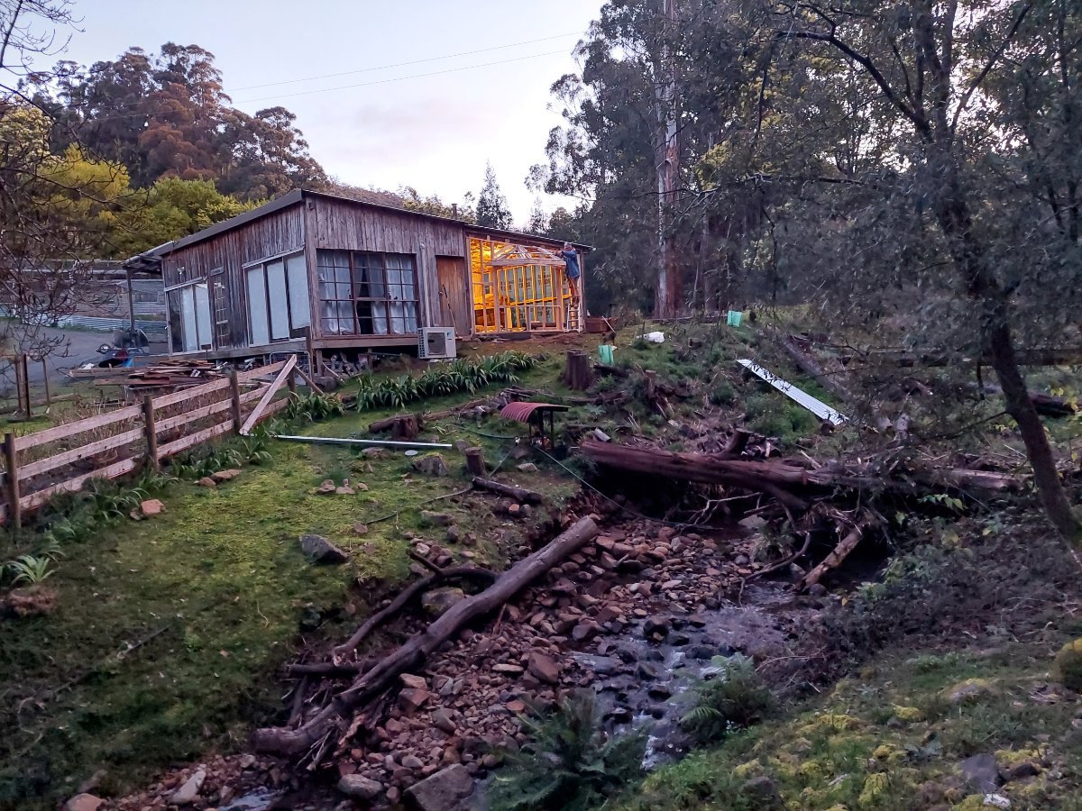

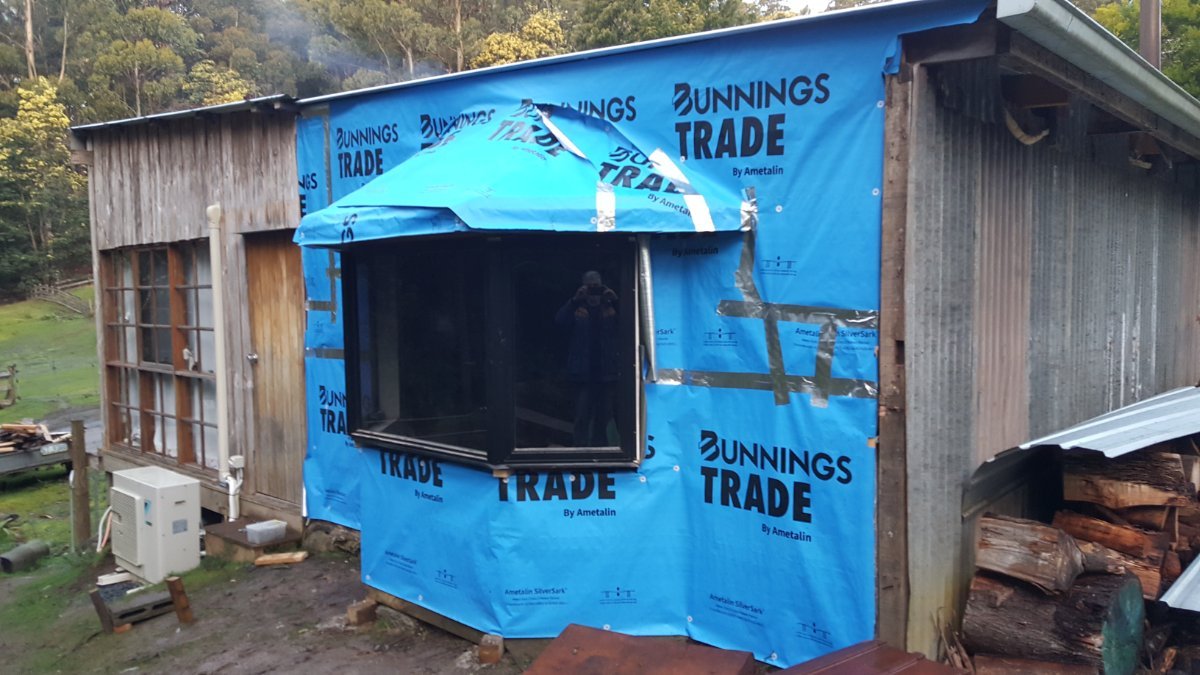

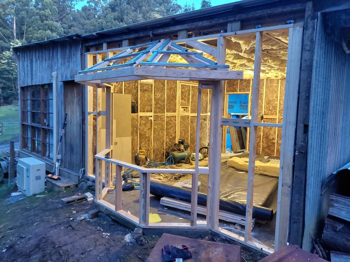

Marty_d Posted September 4, 2022 Author Posted September 4, 2022 Firstly happy Father's Day to all the dads out there - pretty much most of us I guess, not to mention Granddads and in at least one case (Spacey) Great-Granddads! So while this is not exactly a plane update, it is a shed update which involves the plane, 'cos I can't move the plane until I finish the shed and I can't really work on the plane until I move it. Started the weekend at 6am Saturday, by 8am I had the entire end wall removed, by 9:30 I had the new bay window section in (I had pre-built that over the last few weeks), by the end of Saturday the wall was framed up and mostly rough-sarked to protect the inside from any rain. Today I put the foil on properly and taped the joins then placed the window and screwed the reveal to the frame. Still have to fill and properly seal around the window, then I can put the little roof over the top (got the material for that), then batten out over the sarking and put on the EcoPly cladding. Photos tell the story... 4 1
IBob Posted September 4, 2022 Posted September 4, 2022 Marty, that must feel good! Round here, every single Sav build has involved building a complete new workshop, extending a workshop to clear sufficient space, or erecting a hangar. Long time ago an author called Gail Sheehy wrote a book called Passages, where she looked at people who had made major transitions in their lives. The passage is the transition, and what I recall from the book was that many said had they known how long the passage would take, and what was involved, they may not have had the courage to begin. Building your own aircraft is, I guess, less dramatic than that......but it seems to me there are parallels.......) 3 1

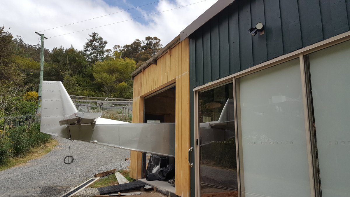

Marty_d Posted January 9, 2023 Author Posted January 9, 2023 With the shedroom finished (we moved in Boxing day) I've been clearing out stuff in the rest of the shed. Today with the help of my 12yo son, we performed a 60-point turn with the plane (along with some sideways lifting) to get it around the corner in the L shaped space. She's now backed up to the roller door and today for the first time, her shapely behind got some sun! 😁 5

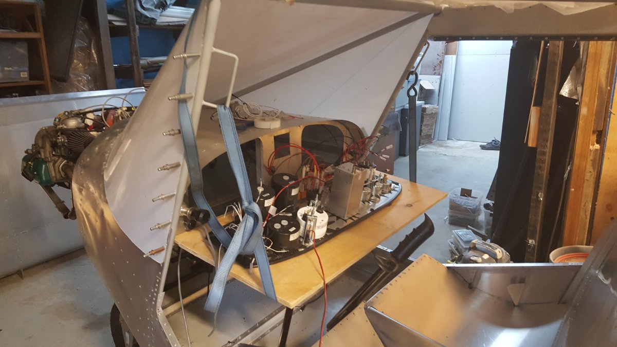

Marty_d Posted January 12, 2023 Author Posted January 12, 2023 Massive "Thank you!" today to @nomadpete who generously offered his time and expertise. He spent the afternoon working out my instrument panel wiring. Still a bit to go but a lot further than I would have got on my own. Really appreciate the help Peter! 3 2
Blueadventures Posted January 12, 2023 Posted January 12, 2023 Are you labelling? One method is write label on strip of paper with fine pencil (biro ink fades) and use clear heat shrink to attach to wire. I kept a sheet of paper, scissors and a very sharp pencil handy and wrote labels for wires, sometimes at both ends to enable later tracing. 1 1
nomadpete Posted January 12, 2023 Posted January 12, 2023 The wiring loom was premade. It already has labels on the wires, but since it was premade for a different aircraft, mods must be made to suit a different layout, and some different items. It is messy at the moment, but eventually will be neat and secure. 1 1 1
Marty_d Posted January 12, 2023 Author Posted January 12, 2023 The loom came with a set of steam instruments I bought. They'd come with a Savanah kit but the owner wanted a glass panel. 2 1

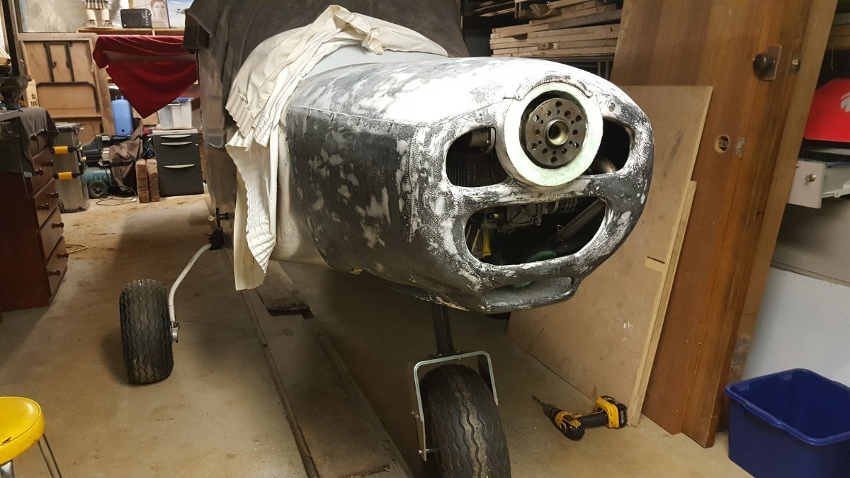

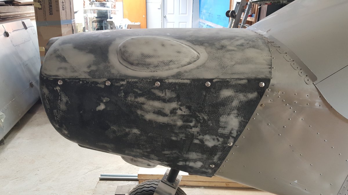

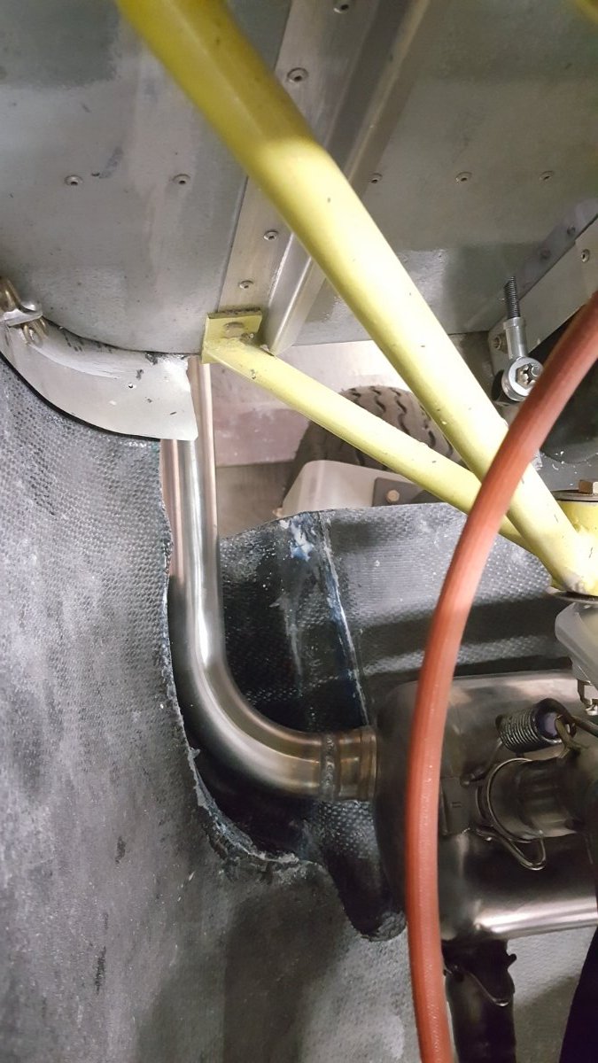

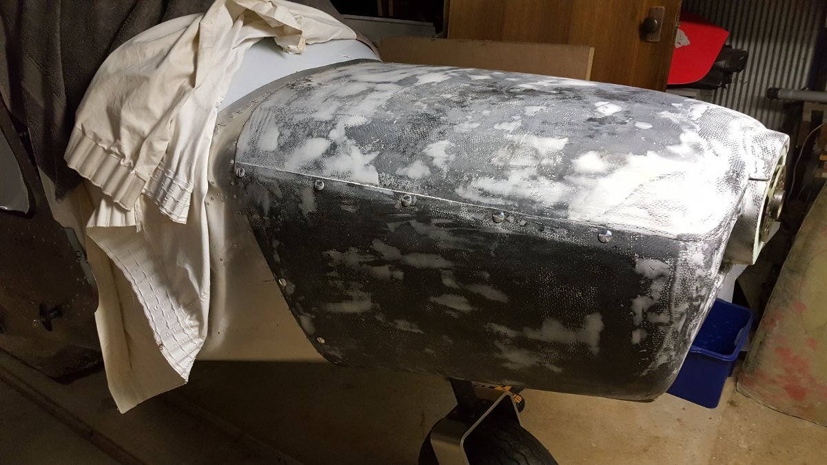

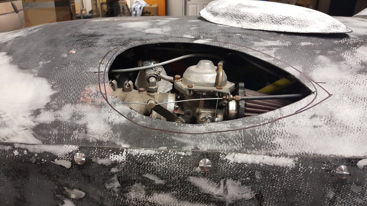

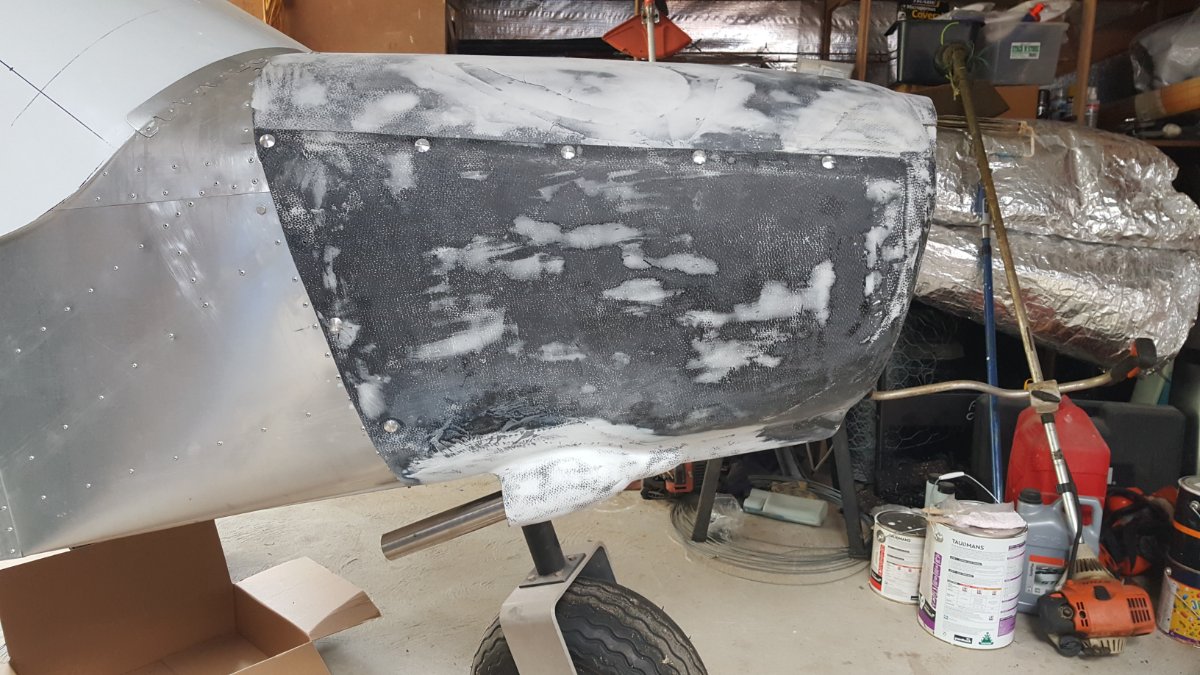

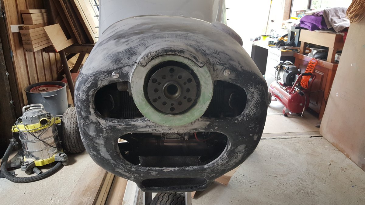

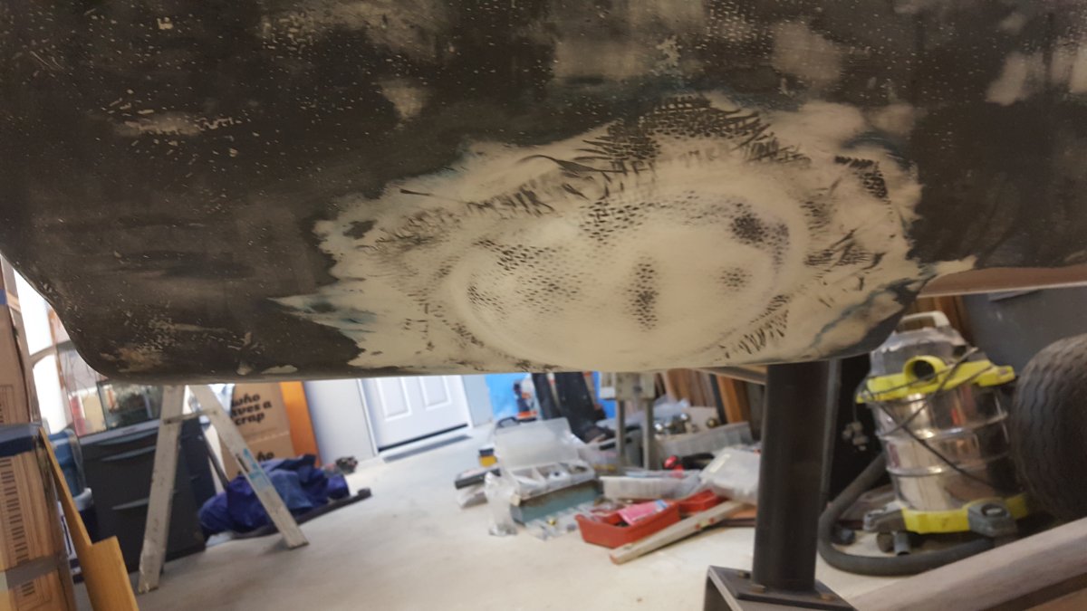

Marty_d Posted January 29, 2023 Author Posted January 29, 2023 In the last week of my holidays I got a bit of fibreglassing done. Think I've finished now (although there's always that last little divot you don't see)... So the bits I needed to add were: - Top cowl: a blister to give the port side carby and throttle body a bit of room, throttle was binding on the cowl. This is because the engine is offset 3 degrees so the back end of it is closer to the cowl on the port side. - Bottom cowl: - a shaped outlet which follows the curve of the exhaust pipe from the muffler - a blister on the opposite side to accommodate the other side of the muffler. 5 1
planedriver Posted January 29, 2023 Posted January 29, 2023 Looks good Marty. Not so, the leading edge ding in last photo?
Marty_d Posted January 30, 2023 Author Posted January 30, 2023 You scared me there Planey, I went and checked. It's not a ding, just the rivet line in the skin. Camera makes it look worse than it is. 1
planedriver Posted January 30, 2023 Posted January 30, 2023 29 minutes ago, Marty_d said: You scared me there Planey, I went and checked. It's not a ding, just the rivet line in the skin. Camera makes it look worse than it is. So glad the camera distorts the truth 1
Marty_d Posted January 30, 2023 Author Posted January 30, 2023 1 hour ago, planedriver said: So glad the camera distorts the truth Always in the wrong way though, never makes me look skinnier 1

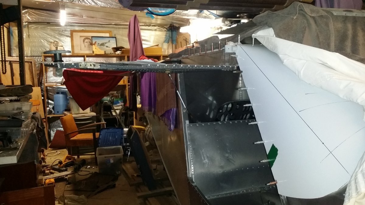

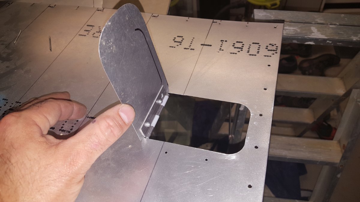

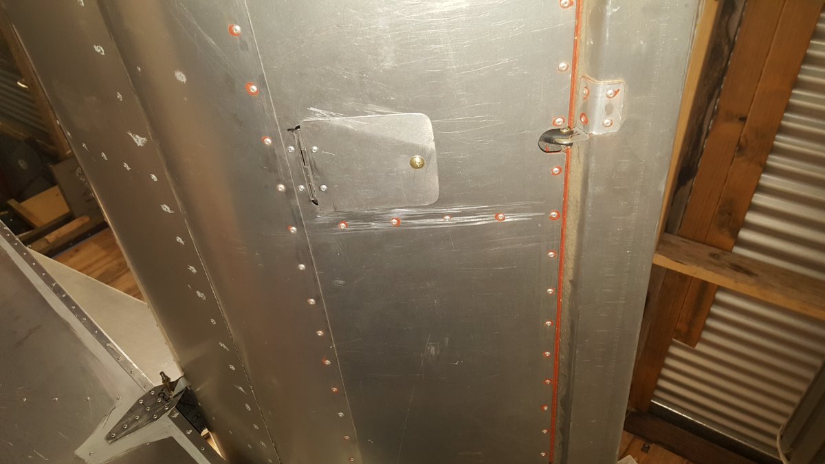

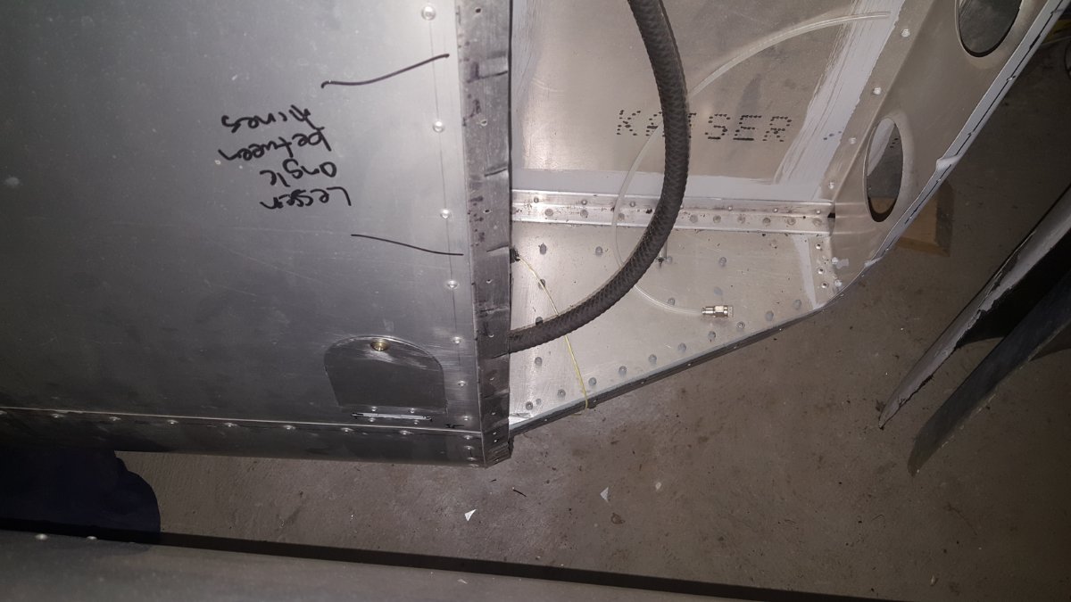

Marty_d Posted February 15, 2023 Author Posted February 15, 2023 (edited) Little doors! I've been building inspection hatches. 4 so far, with a few to go. Two are on the wing roots, near the trailing edge, to access the fuel quick-release attachments. Top of the wing to access where the fuel return hits the tank, and lastly bottom of the elevator to access the trim tab servo. I found the rest of the aluminium piano hinge I used for the doors, so I figured the easiest and lightest way to do the hatches is hinge at the upwind end and single nutplate at the downwind. Edited February 15, 2023 by Marty_d 5
Old Koreelah Posted February 16, 2023 Posted February 16, 2023 Neat work Marty. If security is an issue, is it possible to install a long pin to lock those inspection doors shut? A section of piano hinge can serve as a secure latch, with the release pin accessible from somewhere inside your (lockable) cabin. 1
