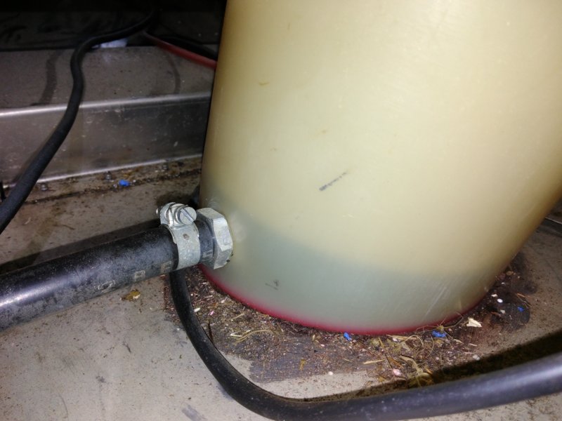

Xavier Posted November 4, 2016 Share Posted November 4, 2016 Hi all, Having the the Engine Monitoring system setup, the decision was made to use one of the Auxiliary Input for Low Fuel warning so it would flash the warning light and make some noise in the headset if the low fuel sensor is triggered, instead of just having the red warning light on the other side of the panel. It is working now and in the process of checking if it was all good I checked how much fuel it would be left just after the Low Fuel warning is on. Result is 6L of usable fuel after the warning is triggered, would be about 30 minutes of flying at a lower RPM with the 912UL, the safety side should probably be 20 minutes. Are you ending up with the same numbers ? Xavier Link to comment Share on other sites More sharing options...

IBob Posted November 5, 2016 Share Posted November 5, 2016 Just measured tank: Internal diameter approx 135mm Height, bottom of level switch to top of outlet approx 400mm. 3.14etc x 6.75 x 6.75 x 40 = 5722cc So 6L sounds about right. Link to comment Share on other sites More sharing options...

IBob Posted November 5, 2016 Share Posted November 5, 2016 Make sure it's available to the engine under ALL conditions. Fuel on board is not necessarily all useable fuel. Nev Sure, Nev: that's an approximation of the tall narrow cylindrical 'receiver' tank behind the passenger seat. So, while you wouldn't want to be down to those last 5+ Litres, I'm pretty sure you would get them all provided your pump was functioning properly. Link to comment Share on other sites More sharing options...
Blueadventures Posted November 5, 2016 Share Posted November 5, 2016 Hi all, Having the the Engine Monitoring system setup, the decision was made to use one of the Auxiliary Input for Low Fuel warning so it would flash the warning light and make some noise in the headset if the low fuel sensor is triggered, instead of just having the red warning light on the other side of the panel. It is working now and in the process of checking if it was all good I checked how much fuel it would be left just after the Low Fuel warning is on. Result is 6L of usable fuel after the warning is triggered, would be about 30 minutes of flying at a lower RPM with the 912UL, the safety side should probably be 20 minutes. Are you ending up with the same numbers ?[ATTACH=full]46699[/ATTACH] Xavier On the sav collector tank the warning light is on when the fuel is about 80mm down. It's a pressure activated sensor. So count on about 5 litres of fuel plus the delivery fuel line to engine. Therefore plan for 15 minutes max engine time. Safe flying Mike Link to comment Share on other sites More sharing options...

dan3111 Posted November 24, 2016 Share Posted November 24, 2016 I have mounted my 12v booster pump beside the header tank on the savannah to help reduce air locks when header tank gets low the fuel pump is then protected with a fuel strainer before is to take large junks out . Link to comment Share on other sites More sharing options...
