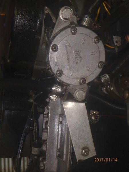

Fox 4 Posted January 11, 2017 Author Posted January 11, 2017 Installing a fresh 582 motor at present , but noticed the existing pulse pump was mounted on edge as opposed to horizontal as recommended by Rotax , pump appears to have operated in this position for some time , but maybe the elec boost pump , also installed , was hiding a problem. , was the pulse pump mounted on edge the standard drifter installation ?
skyfox1 Posted January 11, 2017 Posted January 11, 2017 Installing a fresh 582 motor at present , but noticed the existing pulse pump was mounted on edge as opposed to horizontal as recommended by Rotax , pump appears to have operated in this position for some time , but maybe the elec boost pump , also installed , was hiding a problem. , was the pulse pump mounted on edge the standard drifter installation ? My Drifter has it mounted horizontally but have seen mates Drifter with it mounted vertical had done 800 hrs with no problems .
M61A1 Posted January 12, 2017 Posted January 12, 2017 Installing a fresh 582 motor at present , but noticed the existing pulse pump was mounted on edge as opposed to horizontal as recommended by Rotax , pump appears to have operated in this position for some time , but maybe the elec boost pump , also installed , was hiding a problem. , was the pulse pump mounted on edge the standard drifter installation ? Mine is mounted in the vertical plane. As long as the vent is at the bottom it si OK. Unfortunately the pump is a long way above the point it draws from, and the engine drive fuel pump, I find, a bit marginal if you are lower than half in the belly tank.
farri Posted January 13, 2017 Posted January 13, 2017 Installing a fresh 582 motor at present , but noticed the existing pulse pump was mounted on edge as opposed to horizontal as recommended by Rotax , pump appears to have operated in this position for some time , but maybe the elec boost pump , also installed , was hiding a problem. , was the pulse pump mounted on edge the standard drifter installation ? This is my setup...The pump draws from the bottom tank and has no problem doing so...I`ve had it this way for three of my 582 and now on my current 503...I have an electric pump, but it`s there mostly to prime the Carbies on start up and as back-up, if needed. Franco.
