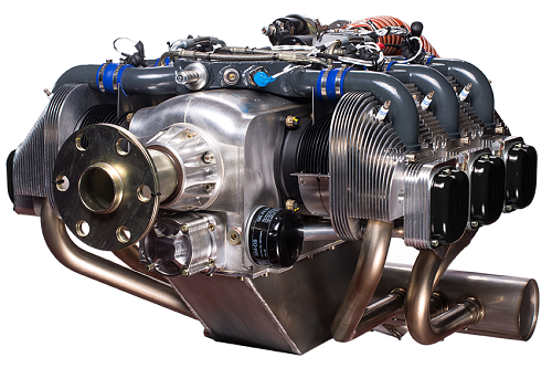

Downunder Posted November 22, 2016 Posted November 22, 2016 Perhaps the j430 with a UL Power 6 cyl (up to 200hp available) or even a 130hp 4 cyl. http://ulpower.com 1 1
