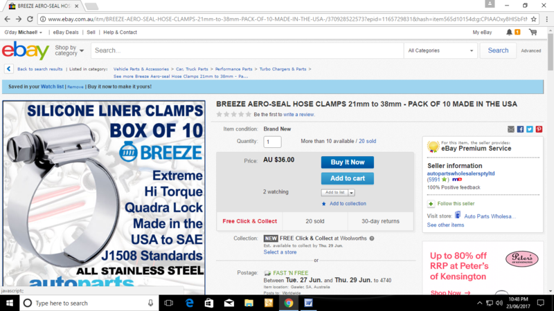

Blueadventures Posted June 23, 2017 Posted June 23, 2017 Hi I'm replacing my coolant pipe system and need some hoses to connect up. I read that Silicone is becoming popular. What is the life and reliability of the 25mm id silicone hose and is it better to get the flexible wire reinforced type? Also best brand and ones not to buy will assist me. The metal pipes I'm fitting are specially made for Rotax 912 to rotax radiator in the UK. I'll post some images of the pipes fitted for general info as I hear good report about them and will eliminate long lengths of hose, measures to prevent collapse on suction side etc. Thanks Mike I found these lined hose clamps that seems like they would be good for both rubber a silicone coolant hose fit ups. Any one used them?
onetrack Posted June 23, 2017 Posted June 23, 2017 These are the best hose clamps you can buy - Tridon T-bolt, stainless, with liner, and with rolled edges on both band and liner. Made in Australia, so you have the satisfaction of knowing that they do have a reliable level of QC. TTBS Series - T-Bolt, All Stainless | Tridon These hose clamps will not strip threads, as the cheaper hose clamp styles are prone to do - they provide excellent, even clamping pressure - and the rolled edges prevent the hose being cut when they are tightened.
planesmaker Posted June 24, 2017 Posted June 24, 2017 Thanks one track always a challenge to find good quality clamps.
