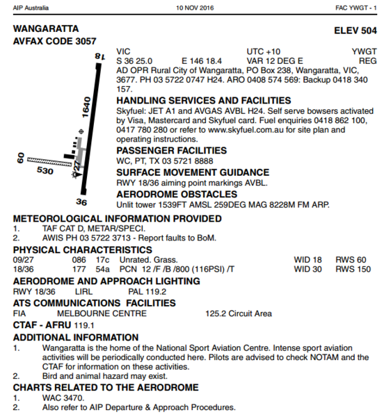

turboplanner Posted December 5, 2016 Posted December 5, 2016 27 is the short grass runway; higher rolling resistance.
bull Posted December 5, 2016 Posted December 5, 2016 27 is the short grass runway; higher rolling resistance.[ATTACH=full]47153[/ATTACH] So????
Happyflyer Posted December 5, 2016 Posted December 5, 2016 So the aircraft was heavy, the wind was light from the SW and the choice of runways was a 530m grass runway to the west or a 1600m sealed runway to the south. The first was a very quick taxi the other a 1km back track. I wonder which choice we would have made... and which choice we would now make with what we have learnt from this? Hopefully I will take the longer runway.

bull Posted December 5, 2016 Posted December 5, 2016 So the aircraft was heavy, the wind was light from the SW and the choice of runways was a 530m grass runway to the west or a 1600m sealed runway to the south. The first was a very quick taxi the other a 1km back track. I wonder which choice we would have made... and which choice we would now make with what we have learnt from this? Hopefully I will take the longer runway. quoted takeoff distance138 mts so what happened to the other 392 mts of available runway???
Happyflyer Posted December 5, 2016 Posted December 5, 2016 Well I think they did end up on the runway so they didn't use all of it. Could be the manufacturer fibbed just a little bit? There are many things that can extend the take off roll. Density altitude? Leisurely acceleration? 138 m quoted for sealed surface? Flaps or not? Maybe not quite full throttle? Carb heat on? Cruise or climb prop? Runway up slope? Remember the Russian pilot resting his feet on the brake causing a jet to crash and kill an ice hockey team?
