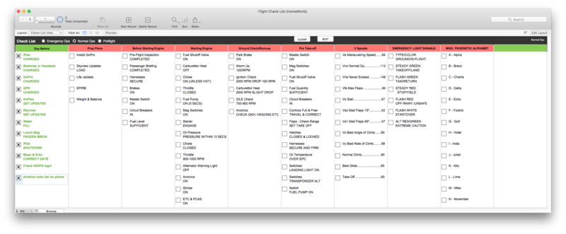

mkennard Posted December 9, 2016 Posted December 9, 2016 I don't fly enough so I use check lists. I wrote my own database after having played with others on the iPad and preferred mine. This is using FileMaker and runs on the iPad. I probably went over the top with the info there but I was on a roll.
biggles Posted December 9, 2016 Posted December 9, 2016 I don't fly enough so I use check lists. I wrote my own database after having played with others on the iPad and preferred mine. This is using FileMaker and runs on the iPad. I probably went over the top with the info there but I was on a roll.[ATTACH=full]47186[/ATTACH] All good MK. I am aware Jabiru recommend '10 secs for oil pressure', but personally I wouldn't leave the ground if the pressure wasn't up in less than half this time ..... Bob
DWF Posted December 9, 2016 Posted December 9, 2016 The sequence of checks/actions can sometimes be important too. For instance, in a Jabiru it is necessary to set the TRIM AFTER the "CONTROLS full, free and correct" check as, if you do it properly, this check will result in almost full back trim being set. 2
mkennard Posted December 9, 2016 Posted December 9, 2016 The sequence of checks/actions can sometimes be important too.For instance, in a Jabiru it is necessary to set the TRIM AFTER the "CONTROLS full, free and correct" check as, if you do it properly, this check will result in almost full back trim being set. I personally do the trim afterwards but looks like it's missing off the list
