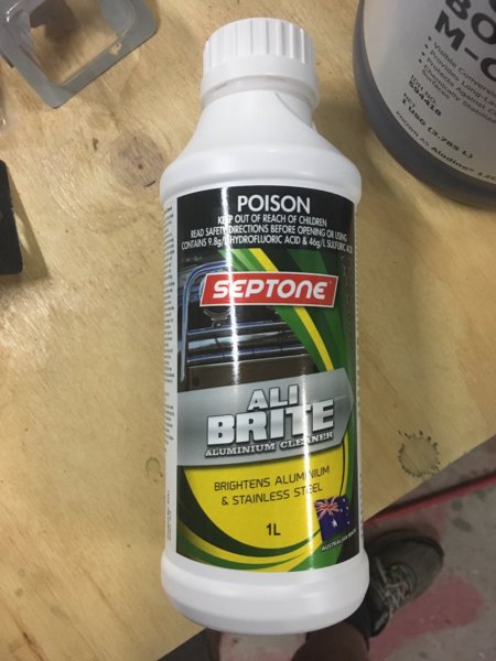

Kyle Communications Posted November 7, 2017 Author Posted November 7, 2017 Hi Richard I use aluminium mag wheel cleaner from a auto accessory store...its cheap and you dilute it I think it was like 8 to one so 1 litre gives you 9. It bubbles up on the alu nicely without being too aggressive and washes off easily. The alodine comes in bottles. The brand name is Bonderite 1200 it is premixed in 1 US gallon bottle and it comes in a box of 4 bottles. For brushing you use it straight but for dipping like I do because it gives a nice even finish you dilute it 2 to 1 with distilled water. The carton is about 15 litres in total so it makes up 30 litres. It is pretty cheap really..although others are paying for 1 bottle that I get 4 bottles for. When I get home I will take a couple of pictures and post them here
Kyle Communications Posted November 7, 2017 Author Posted November 7, 2017 pics as promised Richard 1
rmorton Posted November 7, 2017 Posted November 7, 2017 Hi Mark, thanks for that! It is interesting that I can get Aluprep, which is similar to the Ali bride for 15£ a quart in the UK but here it costs50£ Same story with Aldine :( I did find a powder version and use that to top up the solution when it weakens but in view of the toxic nature I am reluctant to do much more of it.

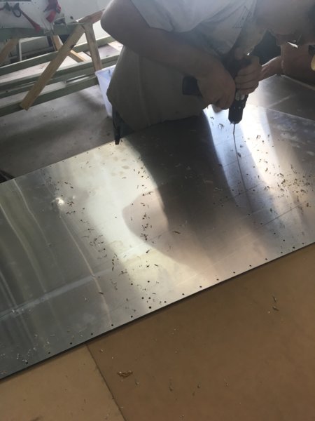

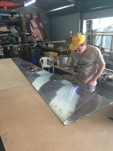

Kyle Communications Posted November 18, 2017 Author Posted November 18, 2017 I must have run over the preverbial chinaman lately Been trying to get stuff done on Mabel as I have just got some free time back Attached are a few pics of Danny drilling the S side skins here at my place. Today I went to the shed and started drilling the top rear wing skins for Mabel That day which was last sunday I was feeling pretty crook and did drill a few holes as well as it so much easier with one doing 1 size of hole and the other doing the second size hole...but I couldnt keep going and went to the doc up the road....they are open on sunday mornings to see if I could get some antibiotics as I thought I must have a infection. I got back and told Dan I had to go and lay down. Dan finished his set and also mine. I ended up in the hospital on sunday arvo :(....They say you got to feel pretty bad before you die....It felt like I must have been close I think..blood pressure was 71/38 and emergency at the hospital were panicking....spent almost a day in there before I had enough blood pressure to send me to the ward...Lots of blood drawn and something like 4 litres of IV fluid and 6 different types of antibiotics were tried to see which was the best treatment. I got out on wed night after pushing to go home..you can not get any rest in hospital but they still didnt have a proper cause for the issue. They think it maybe Qfever. I hadnt heard of it before but looked it up. They took some more blood before I left and they will test the first lot they took again for this now as well. There are many knowledgeable guys living off the land here and work around cattle. Do any of you know much about Q Fever and if the vaccination they have now works?. We have had cattle on the farm for 8 years now and never had an issue. The thing that headed them to Q was I said last time we were up the farm was like 4 weeks earlier but then I did take a quick flight up there 2 weeks before to get some measurements of inside the shed and flew home an hour later. The specialist said that fitted the timeline. Q is apparently airborne in dust etc and its a nasty bit of work. Any experience from guys on the forum would be appreciated I am feeling much better now although still no where near 100% and I take these special antibiotics for 2 weeks twice a day but I can go out into the sun they say I will burn to a crisp in like 5 mins as they make you "solar sensitive" so long sleeve shits and a hat and heaps of sunscreen.

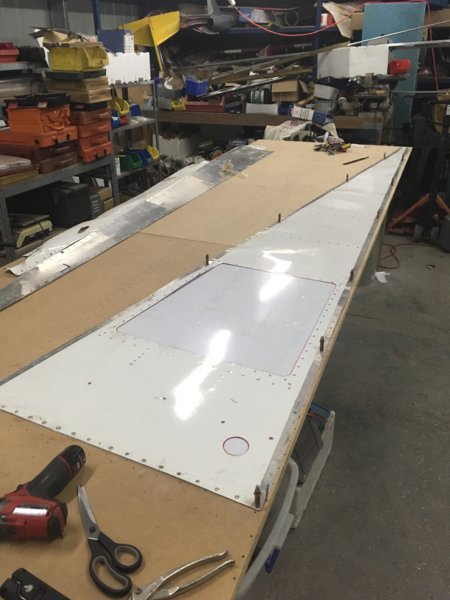

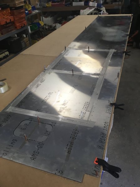

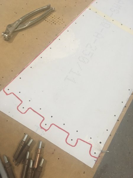

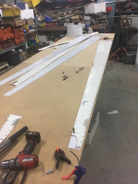

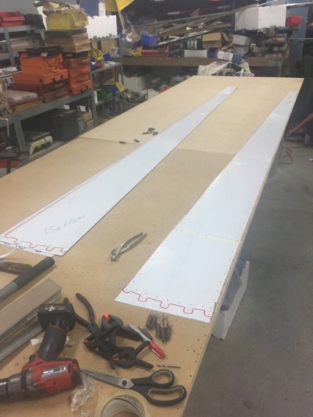

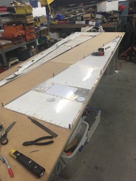

Kyle Communications Posted November 28, 2017 Author Posted November 28, 2017 Well after 4 days in hospital a couple of days at home then on a cruise to Airlie beach where I couldnt do much anyway I am finally feeling a lot better. Still not 100% but far better So got back on saturday from the cruise and was busting to get some work done on Mabel. Top rear wing skins are drilled, Front D skin is drilled and bottom skin is now drilled. Put the top fuselage skin on the bench last night will get that drilled and then setup the bottom fuselage skin then I have the 4 skins that are the curved sides on the rear of the fuselage to do. Then I will start getting the centre section and baggage area disassembled and cleaned and alodined and get it back together. My cabin frame is quite rusted inside when I pulled the alu rear sections out so not happy about that. dannys cabin frame is all bent so he needs to make a new one and I will do the same so we will make a jib from my cabin frame which is nice and straight and make a new one for both of us but we wont have the alu sections in the rear we will make them chrome molly so the whole frame is tigged in one lot. Finally got my temporary cowl from the mold I made glassed by the guy next door at work...he owed me a favour..its only taken a year :)...anyway it has come out of the mold I can now use this as a sacrificial cowl to do all the cutting and shutting to accomodate the proper Rotax exhaust system I will fit. I will then make a much better split mold and this should also work for anyone that has a new 912IS engine in a Sav . I was going to do it on the XL but I think Mabel will get it 1 1

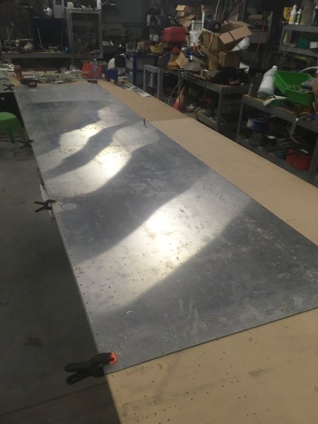

Kyle Communications Posted November 28, 2017 Author Posted November 28, 2017 Top fuselage deck skins all done. The bottom fuselage skins now aligned and pinned ready for drilling tomorrow night 1
Kyle Communications Posted December 4, 2017 Author Posted December 4, 2017 Bottom main skin drilled and then the top curved skins drilled and finally the bottom curved skins so all rear fuselage skins are drilled. All 6 wing skins have all been done. All now to be trimmed then deburred cleaned then I will try painting on the alodine to see how it goes. If I am not happy with that I will make a temporary tank from plastic and wood frame and dip them like before. I have a few bits ordered from Reg as he has a container leaving now with kits in it and I am going to replace the wing struts and have ordered aileron skins and the main spars for the ailerons. That should be here late January or early Feb

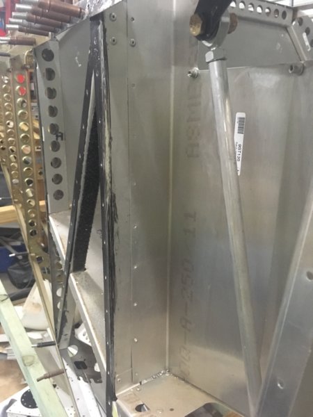

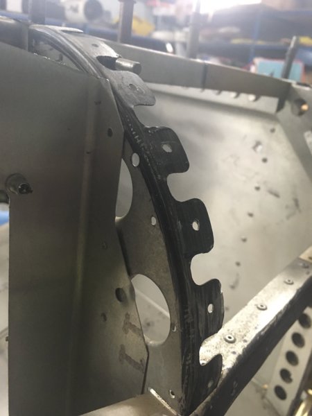

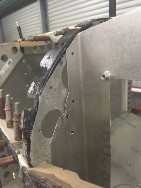

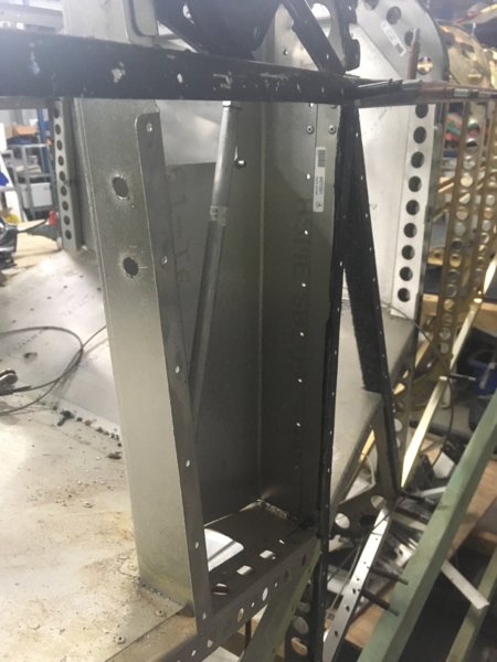

Kyle Communications Posted December 15, 2017 Author Posted December 15, 2017 Yeah well you may remember that I said I wasnt happy about some of the building that was done on Mabel so I decided I would strip the rear cargo area and centre section. Looky looky...no rivets set in the section right behind the main rear wing attachment Maybe just the internal cover section of the aileron rods but the rivets tie the front and rear sections of the first part of the cargo bay. I am really flabergasted that this can happen. I suppose at least with the new Tech manual and the inspections that need to be done before anything is closed up will hopefully pick this up. if it was just the one side I can understand maybe it was forgotten...I dont know how though....but both sides of the aircraft are the same
Kyle Communications Posted December 15, 2017 Author Posted December 15, 2017 I got the build manual with Mabel. Although I havent needed to look at it yet except for ordering parts. I cant believe they didnt rivet that area on purpose
IBob Posted December 15, 2017 Posted December 15, 2017 I'm biting my tongue as best I can here. Yep, it's shit, but the problem is vague, misleading, incorrect or entirely missing order of build.......which of course everyone knows...once they know it!!!
Kyle Communications Posted December 16, 2017 Author Posted December 16, 2017 Thats why I havent used the manual for any building at the moment...I am dreading it when I need to but hopefully I wont need to rely on it. Doing it section by section also makes it easier for the rebuild.
