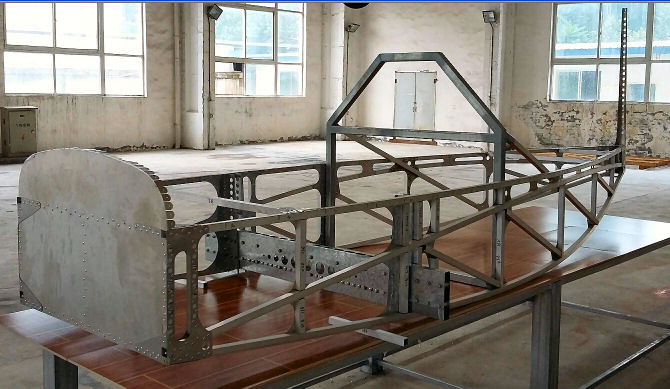

Oscar Posted January 3, 2017 Posted January 3, 2017 Here's a small tip from an experienced aero-engineer: for a low-wing aircraft that does NOT have a proper turtle-deck with a decent 'hoop' behind your head, draw a line from the base of the spinner to the top of the tailplane. If you head in normal sitting position is close to - or worse, above - that line, then you have a very severe risk of spinal compression in an overturn - even a gentle one. 1 4 2

bexrbetter Posted January 3, 2017 Posted January 3, 2017 Quite a number of nosewheel vans have had this experience. Vans do produce an excellent kit. Which is it, do they produce an excellent kit, or do nose wheels fail often? It's not difficult or much extra weight to integrate a real roll bar 1 3 1
