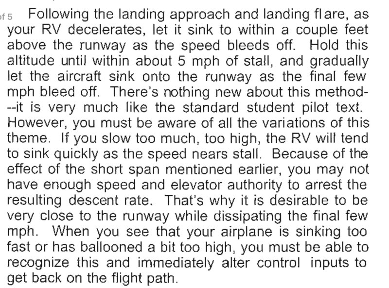

Oscar Posted January 5, 2017 Posted January 5, 2017 Hi, help me out here. Where is this documented? I fly an RV6A and haven't noticed this when landing, or heard of it before. Happy to admit my ignorance but would like to learn more. Ltf: suggest you look at this article: SDS EM-4: Aircraft. Para 6 is a simplistic explanation of the elevator authority problem: his comment about 'not enough energy to flare' actually refers to elevator authority: without the prop wash, at 'normal' final approach speed, there is not enough airflow over the elevator to pull the nose up and slow the descent rate. I cannot find the accident report on a fatal RV6 crash in Australia, though I know the investigator well and remember it. It was an engine-out forced landing into a clear, long, smooth and flat paddock; the evidence showed that it had flown into the ground at a normal approach speed. indicating a failure to be able to flare to arrest the descent. The fatal result was a structural problem; early RV6's without strengthening of the cockpit side members will in such a crash fold back and crush the occupant's heads: this was verified by the autopsy. I would like to stress that VANS has rectified this problem on later models, you should NOT take it that I have a vendetta on VANS aircraft. However, pursuit of the accident reports does show that the RV6 has a noted high accident rate. They are aircraft to be respected and flown accordingly - and absolutely, by no means, unique in that!. May I respectfully suggest that you investigate this characteristic - but at a very safe height. Give yourself a lot of room, cut the engine, and then try a 'normal' final to flare profile. (by 'normal, I mean, maintaining the speed you would use in 'normal' condition). If the reports are correct, you will find that when you simulate the flare, your aircraft will not respond to the elevator movement by an attitude change, a reduction in speed and a reduction in vertical descent speed. IF none of the above conditions happens, then the 'conventional wisdom' is wrong. 1
Love to fly Posted January 5, 2017 Posted January 5, 2017 Thanks for the reply. Google hasn't found me much documentation. I've done many glide approaches (idle engine) in the last 8 years and never had an issue in the flare. As soon as the weather cools down I'll go and have a play at altitude.
djpacro Posted January 5, 2017 Posted January 5, 2017 Ltf: suggest you look at this article: SDS EM-4: Aircraft. Para 6 is a simplistic explanation of the elevator authority problem: his comment about 'not enough energy to flare' actually refers to elevator authority: without the prop wash, at 'normal' final approach speed, there is not enough airflow over the elevator to pull the nose up and slow the descent rate. Your comment is quite a bit different than that reference which states: "Elevator authority will be reduced with no power so the flare will take longer to execute and speed will bleed off faster with no residual idle thrust from the prop." That and the associated text is consistent with the airplanes that I normally fly, looks normal to me. When teaching people in the Decathlon I alert them to the reduced height needed to commence the flare during a "glide" approach. In a Pitts the best glide speed is higher than normal approach speed so, like that reference, it is important to maintain that speed right down to the flare. I see many people letting the speed decay at 100 ft or so as warned about in that article. I have very little time in an RV, just interested. http://www.jasonbeaver.com/rv7/articles/How%20To%20Land%20An%20RV.pdf has similar statements to the reference above. 1 1
poteroo Posted January 5, 2017 Posted January 5, 2017 Thought it time to summarise my experiences in 20 yrs test flying and instructing in RV4, 6, 6A, 7, 7A, 8, 8A, 9, 9A, and 10. Not yet in a 12 or 14. 1 - think about these numbers. We try to make 500fpm approaches in most aircraft - either by using less flap +/- power, or more flap + power. Whatever it takes to give you a more or less constant angle of approach. Most RVs will glide at around 70KIAS clean and give you about 600fpm descent rate - higher with a CSU operating in fine pitch due low power. RV pilots need to adjust their approaches to the magic 500fpm for consistency. 2 - the 9 and 9A have longer wings, more flap area but only 30deg deflection at fully extended. Over the fence at 60KIAS and closed throttle is perfectly safe in all but 15+ crosswinds. Plenty of elevator command remains and they are definitely the easiest/safest of all the RVs. The VANS factory staff love the 9 series. 3 - all the other RV's that I've flown have 40deg flap settings and this does give you a fairly steep approach with closed throttle - steeper if you have a CSU! Preferably hold 60/65 and a touch of power so that you stabilise at 500fpm on mid final. 4 - the early 6 and 6A had smaller rudders and less elevator command. Quickly learned to either keep 65-68KIAS down to the flare (throttle closed)...and avoid highish roundouts. Safest has always been to hold a touch of power on through the roundout and close it , (judiciously), in the flare. In the tailwheel 6 the most reliable landings are, (surprise,surprise), done from a relatively low height flare to a full stall in the 3 point configuration. A bit more 'squirrely' on bitumen, but a delightful feeling of achievement on grass! Wheeling the 6 takes a whole lot more skill and it's something that requires a heap of practice. The technique I teach is for another thread so will stick to the lower speed + near full back stick types. In the 6A - it's even easier than the 6: once in the flare and in ground effect, slowly close what little power remains and increase the angle of attack with more elevator input. You will touch down on the mains with the nosewheel well up. Keep it there! A really good practice lesson is to continue to hold the nosewheel off until you feel the elevator losing command - then add just enough power to allow you to hold the nosewheel off and you can taxy the full length of the runway like that. Teaches you a 'feel' for your pitch inputs in an RV. 5 - in all of my time in RV's, I've never scraped the aft undersection of a wheel spat, nor heard of anyone who has. What does happen with RV's is that the small tyres and infrequent utilisation of most aircraft, allows tyres to deflate. This allows chafing of the tyres on the folded under lower edges of the wheelspat and gives you an alarming smell of burning rubber on taxy. Pump them up to 40psi, or if you don't have a gage - to no more than 75mm of 'flat' on the ground and very little sidewall bulge. One of the most important maintenance items . 6 - RV aircraft are very sensitive in pitch. Pilots need many hours adapting their control stick 'feel' so that they have reduced it down to using just 3 fingers and their wrist locked down against their inner knee. The aircraft can't be landed lightly and with a delicate touchon of mains until pilots have practised and practised their power x attitude basics. And after you master the art of smooth safe landings - try formation in your RV. That requires a whole new control 'feel'. Then after that - try low level in the RV, because without mastery of your pitch inputs you will never be safe either close to the ground or your mates in formation. In summary, RV's are fantastic aircraft which have to be flown with skill and with due regards to the laws of aerodynamics. Don't skimp on either good instruction or on diligent pracrice. happy days, 3 1 6
