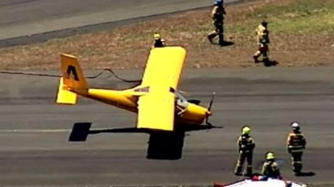

red750 Posted January 8, 2017 Posted January 8, 2017 A Foxbat with 2 on board damaged the nose landing gear in an aborted landing at Moorabbin around midday today, causing the airport to be closed for a while. The aircraft completed couple of circuits and made a successful forced landing on a mattress of foam, with a collapsed nose wheel. Occupants were uninjured.

Nico13 Posted January 8, 2017 Posted January 8, 2017 Interesting that the nose wheel could be pushed back so far in an aborted landing and they still had a prop. One would have thought there was a big chance of a ground strike, not to say it hadn't I guess. Good to see they are safely down. 3
Downunder Posted January 8, 2017 Posted January 8, 2017 As a Foxbat owner, that looked really fast. (could'nt see any flap??) I'm doing touch and goes to walking pace and the front wheel never touches the ground. I don't think the low speed performance is all that different in a Vixen..... I was going to say perhaps a solo student but I see there's 2 on board. 2
rankamateur Posted January 8, 2017 Posted January 8, 2017 The foam disappeared quick. In the video the foam had all gone past by touch down, it is all rearward of the aircraft.
pylon500 Posted January 8, 2017 Posted January 8, 2017 As a Foxbat owner, that looked really fast. (could'nt see any flap??) I'm doing touch and goes to walking pace and the front wheel never touches the ground.I don't think the low speed performance is all that different in a Vixen..... I was going to say perhaps a solo student but I see there's 2 on board. Unfortunately there are those that will try to 'DRIVE' Foxbats (and Vixens) onto the ground, much too fast, and there are a few broken nosewheels around the place. Even flapless, a Foxbat should not touch the ground above 45kts, and the nosewheel probably shouldn't touch till below 30kts. This is such an easy aeroplane to land... 6 1
BoxFat Posted January 8, 2017 Posted January 8, 2017 No idea what happened here, either in the first incident to damage the nosewheel or in the emergency landing so will refrain from speculating. Nobody hurt thankfully and of interest as it is a relatively new type on the register. I own a Foxbat and have flown the Vixxen a couple of times. They have the same wing and both stall at ~ 27 kts full flap. But the Vixxen is much less draggy and does not wash off speed as much in the flare. A little too fast and it will float... and float ..and float. Once again, have no idea what happened here but it is going to be more prone to the drive it on kind of issue than the Foxbat. I wonder if the nosewheel damage compromised rudder control - can't see on the video if it is moving much. 2 1

vixen Posted January 9, 2017 Posted January 9, 2017 The weak nose wheels were the Achilles heel of early Foxbats but they've progressively beefed them up with several design revisions. This Vixen nose wheel should have been the beneficiary of that legacy of an improved strong nose wheel. Just guessing, therefore, that on a previous touch and go the pilot may have subjected it to a very serious side loading (x wind / gusts?) &/or wheel barrow. New to type also? I trust Peter Harlow from Foxbat Australia will be seriously investigating that on this new type.
farri Posted January 9, 2017 Posted January 9, 2017 I trust Peter Harlow from Foxbat Australia will be seriously investigating that on this new type. Yes! and seriously investigate the method being used,by the pilot, to do a touch and go and landing! 3 1

Jabiru7252 Posted January 9, 2017 Posted January 9, 2017 Let me flaunt my ignorance; the foam is a fire-retardant NOT a 'soft landing' cushion (True/false). It was not a forced landing as the engine was working along with all controls (true/false). If I were to find myself in a similar situation in my Jabiru, I would kill all electrics and fuel on short final and then the mags during the hold-off so I don't wreck my prop or engine. 3
turboplanner Posted January 9, 2017 Posted January 9, 2017 Let me flaunt my ignorance; the foam is a fire-retardant NOT a 'soft landing' cushion (True/false). It was not a forced landing as the engine was working along with all controls (true/false). If I were to find myself in a similar situation in my Jabiru, I would kill all electrics and fuel on short final and then the mags during the hold-off so I don't wreck my prop or engine. Well Moorabbinhas one of the smoothest runways in the Nation, you have luxury of landing into wind most of the time on a huge width of runway, there apparently was an instructor on board and they overshot the fire retardant strip almost completely.
ozbear Posted January 9, 2017 Posted January 9, 2017 If you dump the flap after touchdown on the mains you can hold the nose wheel off for quiet along time on the A22 not sure of the A32 but assume it's very similar .I would guess they have approached too fast and tried to force it on the ground and ended up porposing down the runway and damaging the nose leg just speculation at this stage . 2
facthunter Posted January 9, 2017 Posted January 9, 2017 Jab 7252 I don't see why you would remove your option of a go around if things demanded it. It doesn't have to be a "must land this time" situation. The foam confuses me. I thought those days were over and they wouldn't do it anymore. If it WAS needed they didn't really get the benefit of it and it may have added confusion. I don't know. Nev 4
