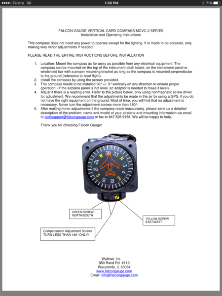

VFR Pilot Posted January 9, 2017 Posted January 9, 2017 I am ready to swing my vertical card compass but I can't find any info on which of the two yellow and green adjusting screws is for N-S and which is for E-W. Does any one know?
VFR Pilot Posted January 9, 2017 Author Posted January 9, 2017 Thanks corvairkr thats just what I needed, cheers 1
Blueadventures Posted January 9, 2017 Posted January 9, 2017 Quote Thanks corvairkr thats just what I needed, cheers If you don't have a brass screw driver you can get a piece of 6mm aluminium rod and hammer one end flat on both sides and file shape to a screw driver end that way the compass does not swing as you adjust with a steel scew driver. 1
VFR Pilot Posted January 9, 2017 Author Posted January 9, 2017 Thanks Blue, I got an el cheapo from Spruce it's just a flat piece of metal shaped a little like a screw driver, cheers
