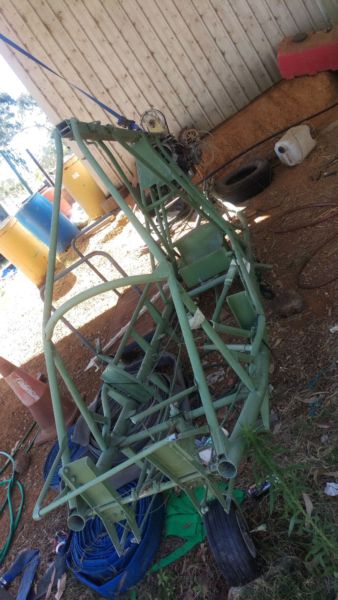

bunyips Posted January 17, 2017 Posted January 17, 2017 Hi Guys, Just wondering if anyone knows what this frame is?
aj_richo Posted January 18, 2017 Posted January 18, 2017 Quadcity Challenger? A side view would help 1
kasper Posted January 18, 2017 Posted January 18, 2017 Quadcity challenger. You can just make out the two lower tubes that shape back into the tail - only pusher airframe I know with that lower fuselage shape and construction. Challenger - Light Sport, Experimental Amateur-Built, Advanced Ultralight & Part 103 Aircraft
bunyips Posted January 18, 2017 Author Posted January 18, 2017 Thanks for that! Going to go have a look at it. Possible project. :)

facthunter Posted January 19, 2017 Posted January 19, 2017 Challenger is a good name for it. I wouldn't fly in one. Nev
bunyips Posted January 19, 2017 Author Posted January 19, 2017 Challenger is a good name for it. I wouldn't fly in one. Nev Mmmm...Sounds like a challenge
ave8rr Posted January 19, 2017 Posted January 19, 2017 Challenger is a good name for it. I wouldn't fly in one. Nev Why Nev?
facthunter Posted January 19, 2017 Posted January 19, 2017 Don't like the struts and wing torsional stiffness. Reported instances of aileron reversal effect. Nev 1
Methusala Posted January 19, 2017 Posted January 19, 2017 Seen them but haven't flown one. James Waller, CFI at Hollbrook in the 90's reported ineffective ailerons. Did not like. 1
bunyips Posted January 19, 2017 Author Posted January 19, 2017 Quad City Challenger, why I won't buy a Challenger ultralight. I read this article and went through some crash reports as well. I am aware of some of the problems associated with this aircraft. If I get it and the motor at the price i think I am then I will post more to do with this particular Challenge/r ;) 1
Yenn Posted January 19, 2017 Posted January 19, 2017 I have flown in one, but only as a passenger. It would not be hard to fly as my pilot was a low time pilot and I helped him out with some advice. The rudder can be too small in the older versions. I worked out some rough figures as to how big it should be and the original was way too small, but there is a designed update that works well.
kasper Posted January 19, 2017 Posted January 19, 2017 And if you are starting with a basic fuselage frame only and are aware of the issues with the original who's to say you rebuild to that form. Add your own wing and control surfaces and you have a Bunyips MK1 not a challenger
Litespeed Posted January 19, 2017 Posted January 19, 2017 And if you are starting with a basic fuselage frame only and are aware of the issues with the original who's to say you rebuild to that form. Add your own wing and control surfaces and you have a Bunyips MK1 not a challenger That's a good idea- fix all the design issues and have a much better wing at the same time. You are basically building a new aircraft anyway- so make as you want it with all the updates/mods that are considered to make a vast improvement. Quad city challenger be damned. Bunyip sounds a good name. Just have a local Aborigine do a smoking ceremony before first flight. The Bunyip can be a deadly beast. 1 1
