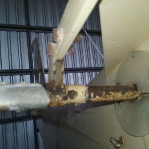

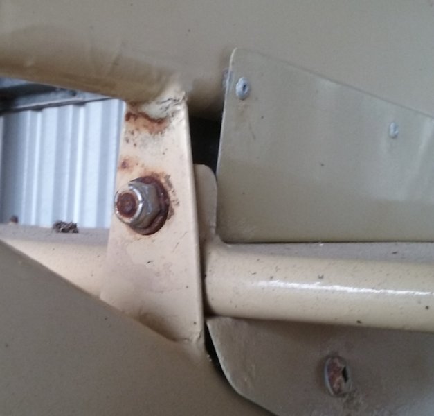

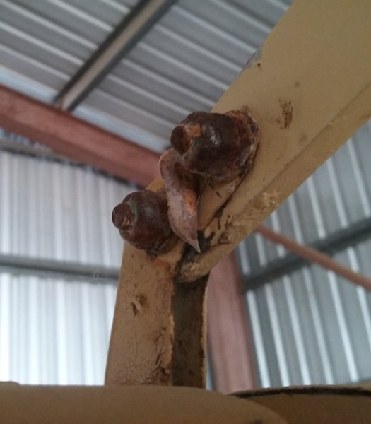

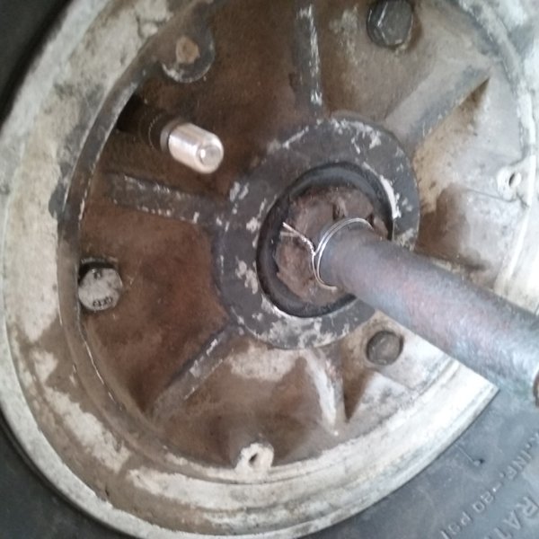

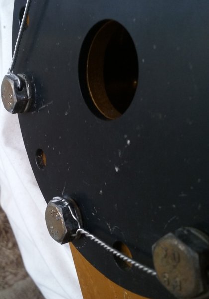

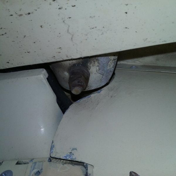

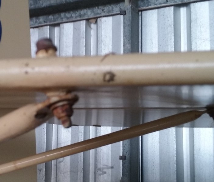

306699706_PortHorizontalStabiliserSupportStrutNutAndBolt-Copy(2).jpg.37dac3bca34c2cb6b0d57c5d39f369d5.jpg G'day All. Just wondering if I might be able to ask the views of the panel? Long story short, I'm an ex GA pilot looking to get into recreational aircraft, with the goal of eventually building my own. Tail-end of last year I Googled flying schools in the area and decided to go out and have a squiz and a yarn. Being new to RA, I'm not too sure on the rules and regulations for the different registrations, but one of the aircraft triggered a "What The Fark !?...Mob of Dodgy Can'ts!" response. Just wondering if this is considered a serviceable or unserviceable condition, and common for RAAus aircraft?
Also, the corroded Flaperon hanger assembly did not appear to have any bearing or bush fitted, so the whole mechanism wobbled like an Elvis impersonator with Parkison's. Is this normal?
Cheers

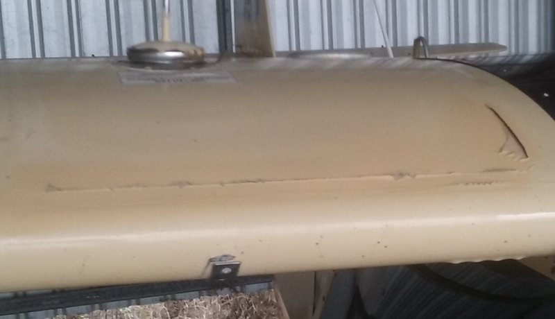

Check out the condition of the flap feed through / linkage (top right hand of photo) - looks like the first photo of the post - just on the opposite side - - mmmmmm!
  • Agree 2

If they're some of the things you can see from the outside; I'd hate to see what's inside where its not accessible.

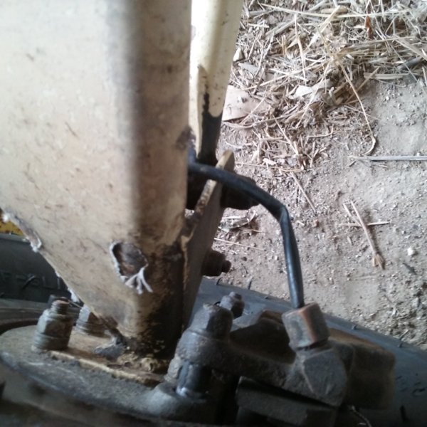

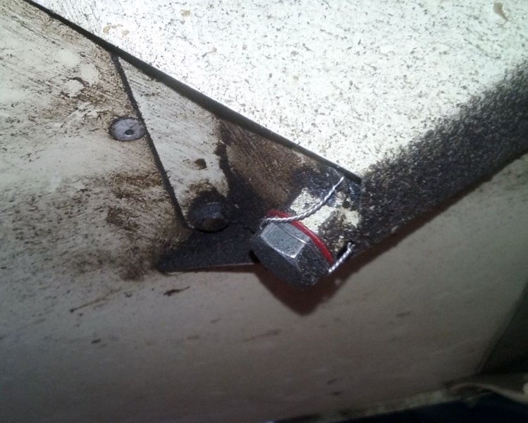

I agree with David that the aeroplane is most likely to be an abandoned love child. That would account for the visible corrosion; fabric damage and what appears to be hangar rash to the brake fluid line.
Let's look at the story on the assumption that the aeroplane has been sitting unloved.
  1. If it has been sitting for years, as the corrosion suggests, then its maintenance release would have expired. Therefore, it needs a thorough inspection before being released as airworthy.
  2. As a result of the inspection, the many faults recorded in these photographs would be rectified - some with a wire brush and paint, others with component replacement.

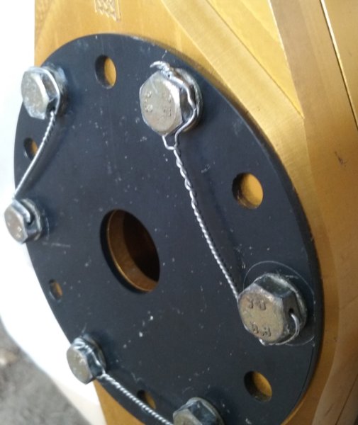

  3. The worst failure I can see is the way the safety wiring has been done on the prop bolts. Upgrading the skill set of the person who did it should only take about half an hour, including theory, demonstration and practical.
  4. There are bolts missing from the wheel hub - maybe they went off via a Midnight Spares incident. The function of the safety wire on the axle is indeterminate.
I agree with robinsm that it looks like it would be a good restoration project.
To answer NotSo's question ( Just wondering if this is considered a serviceable or unserviceable condition, and common for RAAus aircraft?) Yes it is unserviceable. Is it typical of RAA aircraft? No, the great majority of private owners and commercial operators lavish attention onto their aircraft. However, as in all activities, there are some owners and operators who believe that a machine does not need care and attention to operate forever.
