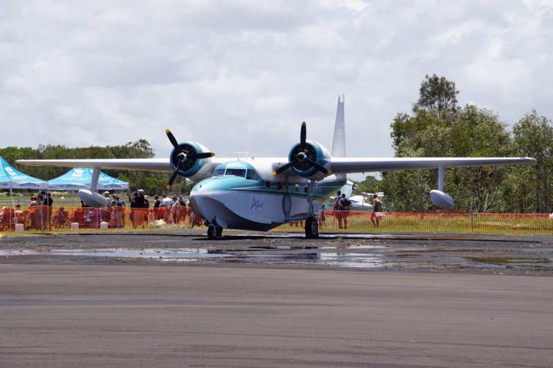

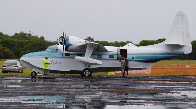

WayneL Posted January 27, 2017 Share Posted January 27, 2017 Photo of aircraft taken at the Great Eastern Flyin at Evans Head on January the 7th this year. Wayne. Link to comment Share on other sites More sharing options...
Downunder Posted January 27, 2017 Share Posted January 27, 2017 Very nice...aircraft, boat and caravan all rolled into one.... Link to comment Share on other sites More sharing options...

Jabiru7252 Posted January 27, 2017 Share Posted January 27, 2017 The Mallard looks as strong as a bull - I'm surprised it smashed up so much. 1 1 Link to comment Share on other sites More sharing options...

dutchroll Posted January 27, 2017 Share Posted January 27, 2017 The Mallard looks as strong as a bull - I'm surprised it smashed up so much. Most likely a consequence of this...... The swan river was very shallow. One other thing I didn't mention previously was that in a wing-drop stall situation like this appears to be, the instinctive reaction is to apply opposite aileron, which will generally make the situation rapidly worsen. It's good to practice stalls like this at a safe altitude in aircraft prone to it so you learn to quickly recognise it (the Winjeel could violently drop a wing in a turning stall). On aircraft not prone to it, it's good to see the resistance of that aircraft to wing drop too. Obviously with an instructor until you're proficient and confident enough to practice yourself (if you want to do that). 3 1 1 Link to comment Share on other sites More sharing options...
