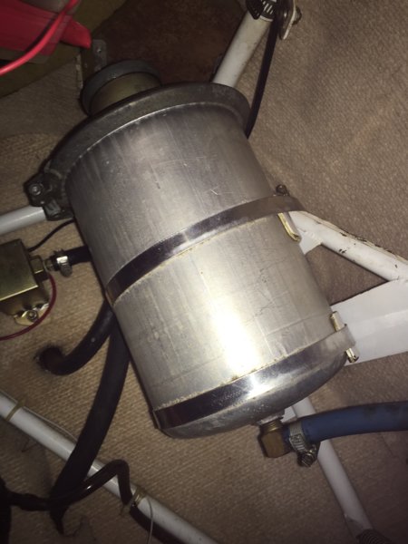

I'm Moving along with my maintenance, and I discover that my oil reservoir is alloy. It seems that many years ago Rotax issued a SB requiring replacement by a stainless steel tank. The alloy ones had been known to crack.
Anyone with a GA please tell me what tank you have and where it is mounted.
Mine has been modified (by factory), and it is located on the inside of firewall without an access hatch to check oil level. It has a non standard hose welded into the bottom of the tank, plumbed throught firewall to a dipstick in the engine bay.
So, to install the correct SS tank, I'll have to modify the fibreglass cowling to make an access hatch. Or get a non standard pipe welded into bottom of the new tank.
Any ideas?

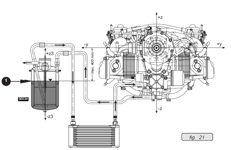

Why not put new oil tank where alloy one is remember the height of of that tank is critical
I have this thought it's the same size different plumbing I don't like the idea of excessive welding of stainless steel

If it's 19xxxx or such just keep using it and inspecting it. Aluminium is used for many motorcycle and race car tanks. Arguably better than fibreglass. Your oil cooler is aluminium. Nev
Thanks guys. Oil draining is a painful task. Crawl into the foot well space and balance a shallow basin on the rudder pedals.... Refilling is done through the dipstick tube in the engine bay.
It's a 55- registered factory built flying machine, so modifications are not allowed (without CAR 35 certification). Maybe I can drill a hole for the extra outlet, and fit a brass hose fitting secured by a nut on the inside of the new tank. That way it complies with the Rotax directive without modifying the aircraft (or welding anything)
Unless it's very thin I would modify it with an aluminium fitting and TIG it in place. Clean it out thoroughly at the same time. It's a standard repair technique. Can't be rocket science and aluminium is probably lighter than the alternative. Nev
