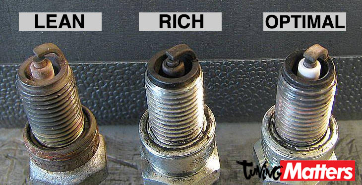

Using the colours of the deposits on the plugs in the attached photo, which colour is closest to the residue on your heads? (Disregard the labelling at this stage)

The colour on a plug can indicate it's too hot a plug (or too cold). Long thin insulator is HOT running and short thick is cold running as well as an indication of mixture being correct. To get a mixture indication of any value the engine should be "CUT" after a reasonable period on full power. This isn't very good for it and inconvenient also. Taxiing is low load and will normally result in some soot being on the insulator so devalues the whole effort. A too Hot plug may look as though it's lean and may cause detonation or engine running on after switches are cut, if you do that as a test. A plug not tensioned enough may run too hot also. Nev
Hot or cold plug - Are the plugs the type and rating called for by the engine manufacturer?
Plugs tight enough - Check that plugs are torqued to correct value
The pictures I posted are from a car source, so the fuel used by them would have been mogas.
Assuming that the colour of the deposit is similar to the "lean" plug, then an examination of the mixture strength would be a sensible step. For starters, are you fuel consumption figures LOWER that similar age angines and the manufacturer's published claims?
