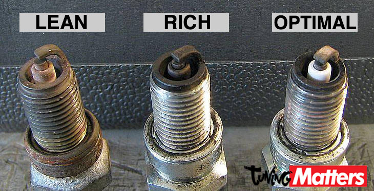

bexrbetter Posted February 12, 2017 Posted February 12, 2017 [ATTACH=full]48302[/ATTACH] The pictures depict plug heat range, someone has incorrectly labelled them as being mixture related. The left is way too hot a plug, showing heating all the way down the threads, the center is way too cold (and fouling) with not a single thread having been heated, and the last is indeed "optimal" showing more than 2 and less than 4 threads having been heated. The same engine with the same fuel mixture ratio would have been used for this demonstration. If you do not read the threads first then you are wasting your time. Coking on air cooled engines is primarily caused by early rich running (oil and fuel) for too long on an engine that takes a long time to come to ideal operating temps. 1
facthunter Posted February 12, 2017 Posted February 12, 2017 The left plug has overheated. Even shows on the plating of the body of it. People go silent when I bring up the subject of what heat plugs to fit. It's not enough to just fit the makers recommendation without any follow up analysis of how they are working. In a Corby starlet which is slippery the motor is not loaded as much as it would be in a slower more draggy plane. If you run at high throttle openings at low altitude you are getting horsepower out equals HEAT as well. Slower forward speeds as when climbing changes things too. Plug ceramics self clean by reaching dull red heat. If they overheat, the engine will almost keep going with the ignition off, as they act as glow plugs. This gives uncontrolled firing of the mixture and possible severe engine damage, as it will fire before the spark happens. In my view it would be better to run a slightly cooler plug where you engine is working harder than run the risk of engine failure. Jabiru have always stressed the importance of not overloading the motor. (too much pitch, blade area or diameter). It's like running a vehicle with too high a top gear. If you run cooler plugs and overdo it you might get plug fouling with long taxi times, as that's when they soot up if they are going to. Short time at full throttle and they clear the soot coating . If the engine's sick and there's oil involved that may not happen so readily as you might have a "cold" cylinder. As you commence take off roll, always check engine revs, AND MP etc if a C/S prop. It if it doesn't reach normal power indications straight away abort the take off, and have it rectified. Nev 1
old man emu Posted February 13, 2017 Posted February 13, 2017 Bex, I'm not disagreeing with what you said, but you should have read the caveat in my post: Using the colours of the deposits on the plugs in the attached photo, which colour is closest to the residue on your heads? (Disregard the labelling at this stage) I was only using that picture to get at a colour reference. OME 1 1
bexrbetter Posted February 13, 2017 Posted February 13, 2017 I was only using that picture to get at a colour reference. Wasn't having a go Mate, merely offering some information for the Plebs.
old man emu Posted February 13, 2017 Posted February 13, 2017 Wasn't having a go Mate, merely offering some information for the Plebs. OK 1
