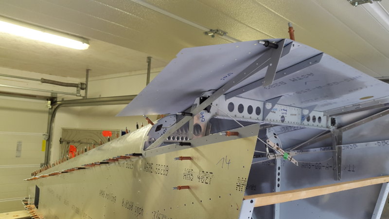

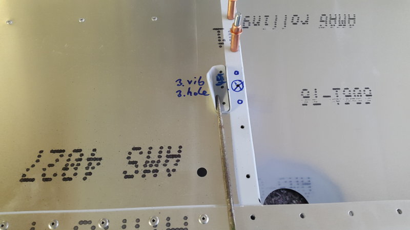

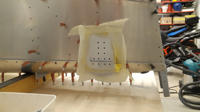

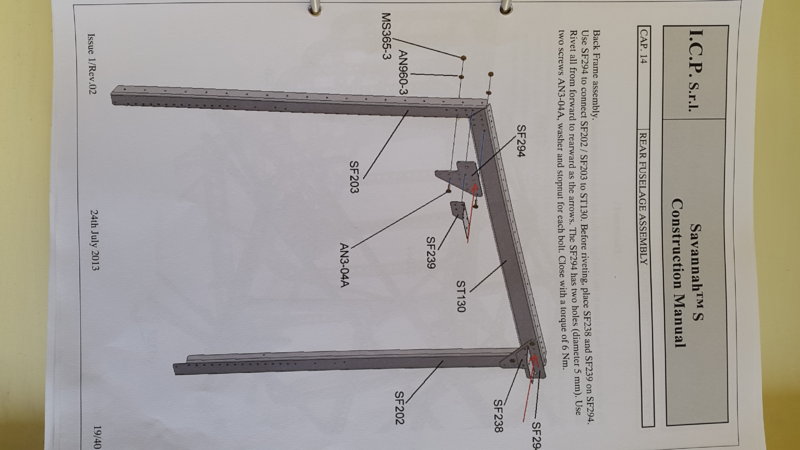

Well, I marked the position, where I would position the brackets for the wing support. I have just one wingtank, so rib 3 is on the outside of the tank. The middle of the small pieces go to 3. hole. Right?20170524_161306.jpg.42c8d82abe8da21b52184803a9f4a2bc.jpg
I would have to check but I am pretty sure I didnt have to drill any holes..but mine was a XL. Thw wing and struts are exactly the same. I will look in the manual tomorrow. I also have a S build manual here as well

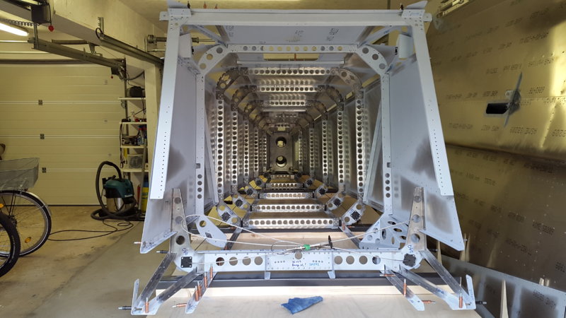

Anyway, last weekend, after prepping all parts, I started the rear fuselage. This went quick and was so much fun. Even the manual is great!!!
Thanks, but don't worry. I took pictures of the factory plane and are fine now.

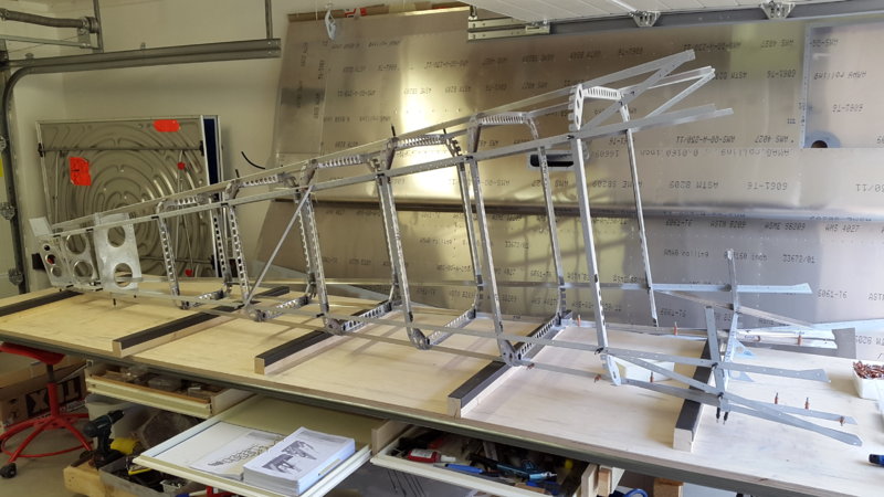

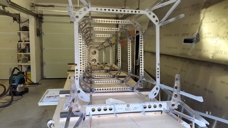

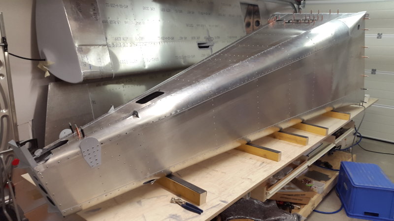

Way ahead of schedule I just finished my rear fuselage. It was a great joy to built. Even the manual was good to read and understand.
So much earlier than expected I have to think about the next steps and the next things to procur.

I'm the beginning all goes fast because the big parts are easy to make.

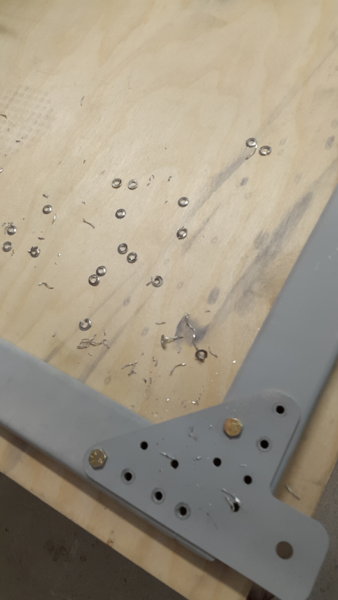

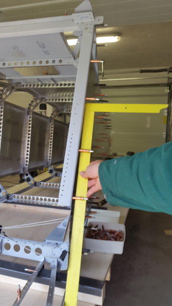

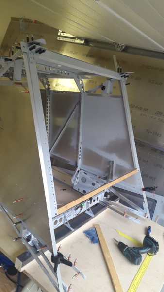

A part that gave me a hard time, was the first frame of the rear fuselage. I rivited and drilled out for 3 times!!! Alway tried to get the angle right and failed. Finaly I clecoed the part together and used a peace of wood to fix the angle, while the frame was in the plane.

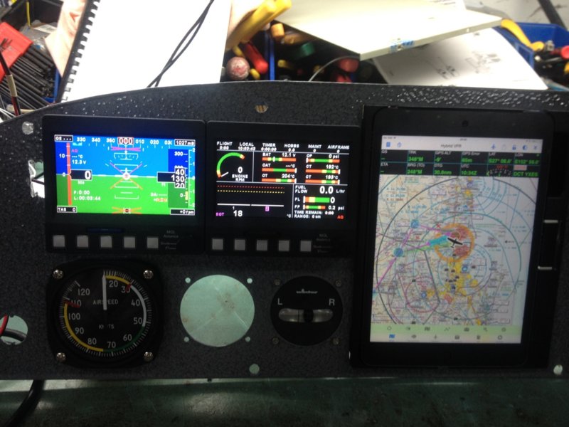

No the Xtreme has it all in the one unit. You get the RDAC which hooks to the engine sensors and you can scroll through each page or you can split the screen so it has it all on the screen at once
O.K. but you need a rdac for the engine and an iBox for the avionic sensors. Right?
I have 2 of the Xtreme EFIS but you can also by a EMS only that looks exactly the same but it isnt a lot cheaper thats why I got the 2 EFIS and just use the 1 RDAC and I run one EFIS on the AHRS page and the other EFIS on the EMS page..I dont use the all in one page it gets a bit cluttered.. I also have the AHRS and Compass module to make it more accurate but it has it inbuilt just like the Avmap one you dont need to get them if you just want to keep the cost down

I installed my RDAC on the pax side inside the cabin. I dont have a picture of it I dont think but will see what I can find. All the sensors just go to the RDAC its really simple
  Quote
yes pitot and static connect directly to the back of the unit
