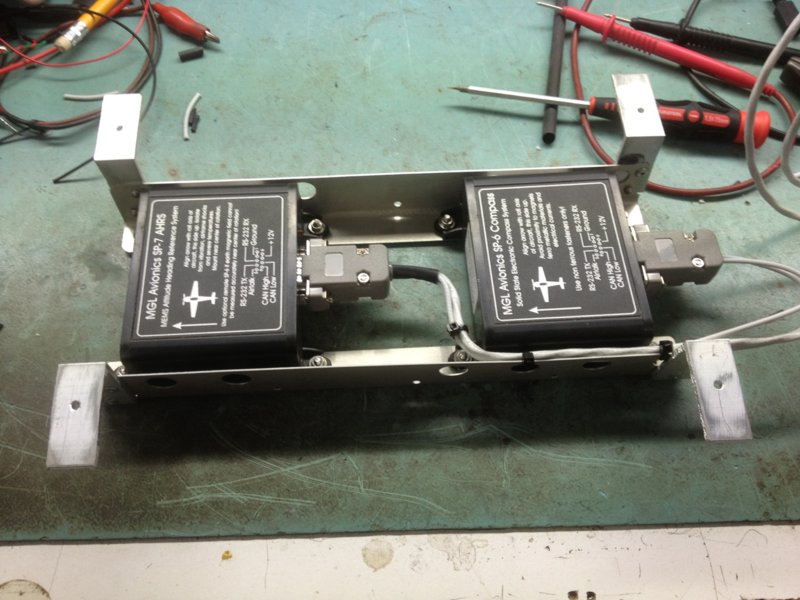

Kyle Communications Posted June 12, 2017 Posted June 12, 2017 The EFIS has multiple pages for AHRS display, GPS heading, Engine Management, notes, checklist and setup etc. The EMS only has the engine management tuff. Both devices use the RDAC . The RDAC is only to interface to the engine sensors. The RDAC can connect to both units at the same time via the CAN bus. There is a separate AHRS unit and a separate compass unit again that connects to the CAN bus this will supply much more accurate information than the one built into the actual EFIS and will take over automatically if connected to the system. So in my aircraft all I have is 2 of the EFIS and one RDAC plus the separate AHRS and compass modules. I have fuel pressure. oil pressure 2 x EGT and 2 x temp sensors and also fuel flow sensors connected to the RDAC

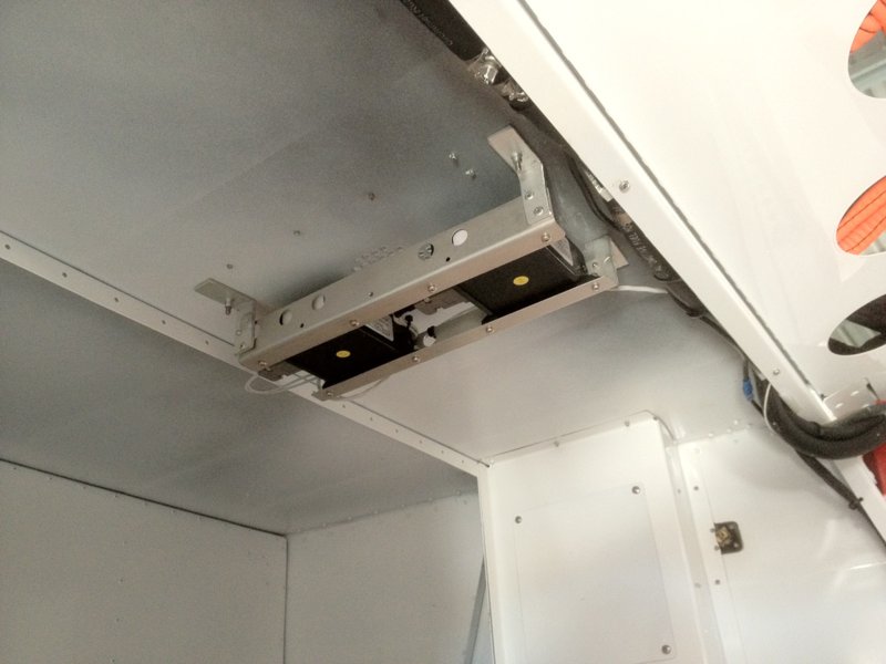

Kyle Communications Posted June 12, 2017 Posted June 12, 2017 This is my separate AHRS and compass modules and where I mounted them

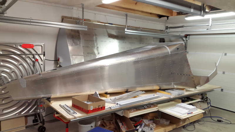

eightyknots Posted June 15, 2017 Posted June 15, 2017 Way ahead of schedule I just finished my rear fuselage. It was a great joy to built. Even the manual was good to read and understand.So much earlier than expected I have to think about the next steps and the next things to procur. - Avionics : a bundle of AVmap Ultra Efis and Engibox would be nice and space saving. A small 4,3" MGL double would be nice too, but its 2.500 Euro compared to 1.500 Euro for Avmap - carpet or no carpet, is an other question - seats (non adjustable), buy them from ICP or make them [ATTACH]50762[/ATTACH] [ATTACH]50763[/ATTACH] [ATTACH]50764[/ATTACH] [ATTACH]50765[/ATTACH] [ATTACH]50766[/ATTACH] [ATTACH]50767[/ATTACH] [ATTACH]50768[/ATTACH] Nice Tom, What is next?

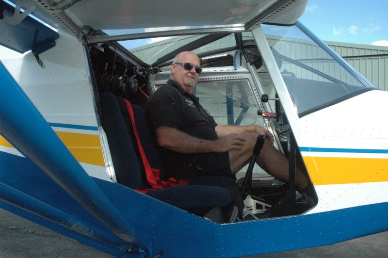

MajorTom Posted June 17, 2017 Author Posted June 17, 2017 Right now I am assembling my baggage compartment. In one built I don't remember, there was a headphone terminal on behind the heads. Is this a good practical idea? How to do it? Is this possibly a standard part to buy?
Kyle Communications Posted June 18, 2017 Posted June 18, 2017 Not that I have seen Tom...most just make a bracket and fit the 2 sockets to it....also some make a bracket to hang the headsets on as well....just above your head on that front section of the baggage compartment..in the middle
MajorTom Posted June 22, 2017 Author Posted June 22, 2017 most just make a bracket and fit the 2 sockets to it I have no clue, how to do it. What is a practical place for the headset sockets? Herhaps someone has a photo. This is so much easier to understand for me. I make good progress on my fuselage. But I miss the excelent chapter summeries from IBob. The "Do's and Dont's" where most helpful and prevented me from bad mistakes. So I try to read and understand Kyles Blog.
IBob Posted June 22, 2017 Posted June 22, 2017 I have no clue, how to do it.What is a practical place for the headset sockets? Herhaps someone has a photo. This is so much easier to understand for me. I make good progress on my fuselage. But I miss the excelent chapter summeries from IBob. The "Do's and Dont's" where most helpful and prevented me from bad mistakes. So I try to read and understand Kyles Blog. [ATTACH]50876[/ATTACH] [ATTACH]50877[/ATTACH] [ATTACH]50878[/ATTACH] [ATTACH]50879[/ATTACH] [ATTACH]50880[/ATTACH] It's kind of you to say so, MT, thank you. There has been a bit going on here, and a large pause in my build: You are going very well, by the look of it, and are just about up to where I am now. But, in case you didn't pick it yet from Kyle's blog: don't rivet in that panel behind the seats: it's a great deal easier to fit the controls and mixer etc with that panel removed...
Kyle Communications Posted June 22, 2017 Posted June 22, 2017 Hi Tom I found a couple of pictures that sort of show the headset bracket in a friends aircraft...another sav. Its mounted on the front edge of the baggage section at the top. Its just a bent alu bracket

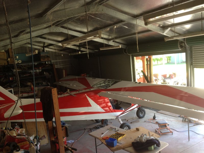

MajorTom Posted June 22, 2017 Author Posted June 22, 2017 Thank you. That's a good idea. Good place. Paintjob lookes nice too. I was kind of thinking about doing mine in dark and light grey, but a friend of mine is telling me all the time this looks old... Best color sheme I have seen so far is on the red/white factory savannah...

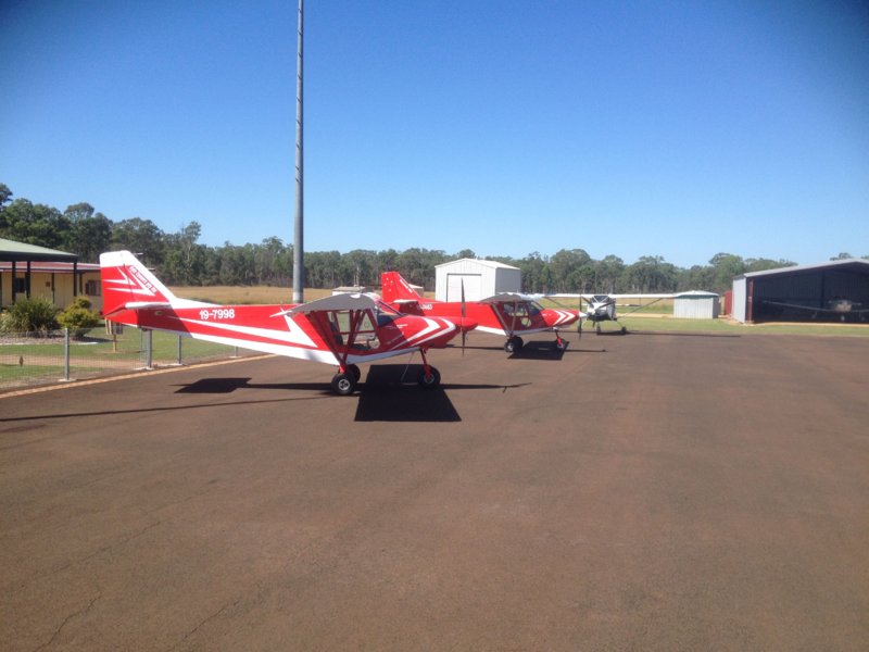

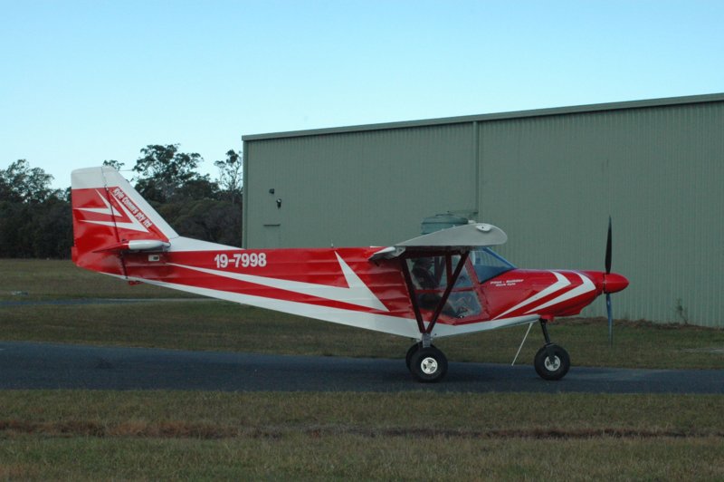

Kyle Communications Posted June 22, 2017 Posted June 22, 2017 The S model I am rebuilding I will paint very similar to my XL that I painted. I like the red and white. It stands out so you can be seen easily. Although I am open to a new design. Mine is just like the factory one but I put a large "tick" on the rear fuselage section you can see the difference between Dan3111's savannah and mine. in the photo. I also put the red flashes on the top of the wings that really makes her stand out
