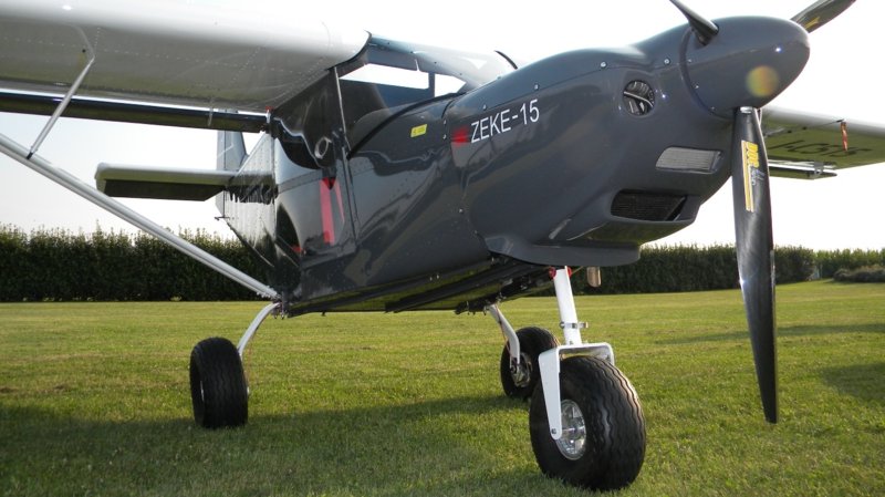

eightyknots Posted June 30, 2017 Share Posted June 30, 2017 [ATTACH=full]51005[/ATTACH] [ATTACH=full]51004[/ATTACH] Which colour are you aiming for: the top (GEMILIS AERO) or bottom Savannah (ZEKE-15)? Neither of them appears steel blue to me. Link to comment Share on other sites More sharing options...
perrynz Posted June 30, 2017 Share Posted June 30, 2017 Gidday Hank. You are correct. Neither are steel blue. The colour scheme is what I am going for. Replace the dark colour with steel blue. I like the contrast with the white MLG/NLG etc. Have you ordered your kit yet? Link to comment Share on other sites More sharing options...
