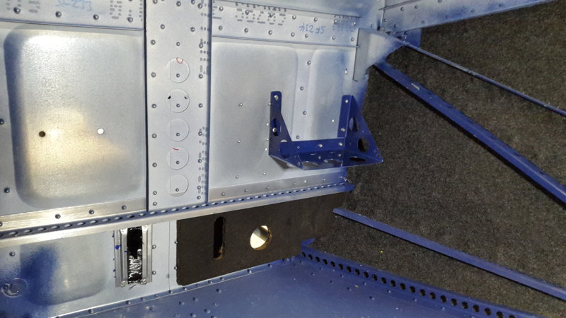

had some time for some serious work...

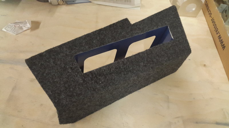

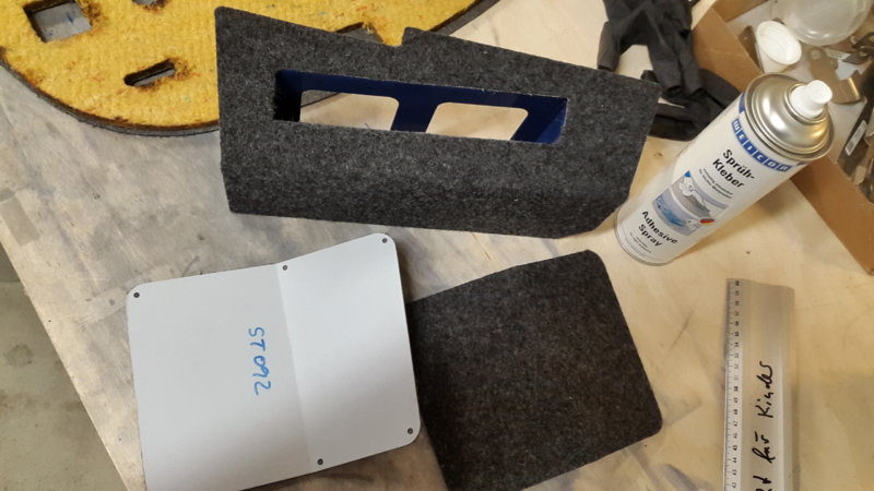

- did the card holders, nice to have, because the cover the cables

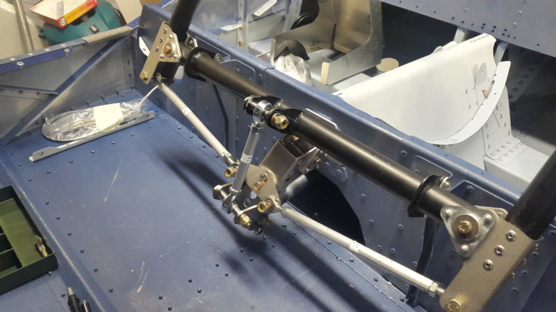

- put the double steering togehter

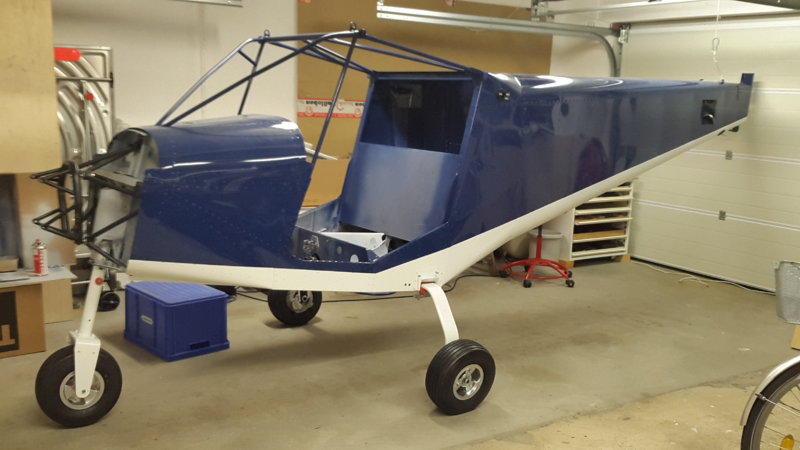

- got the bird on ist wheels

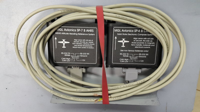

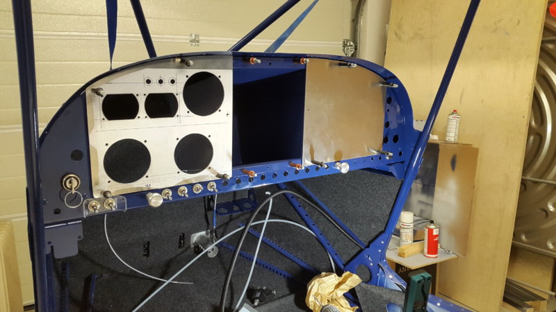

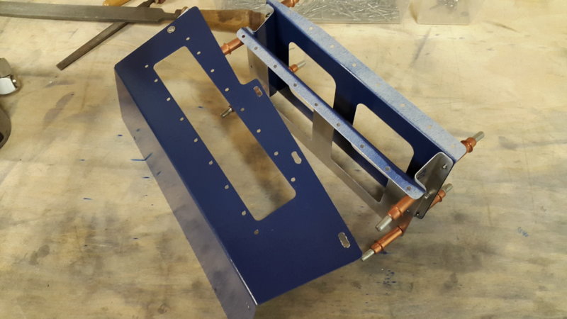

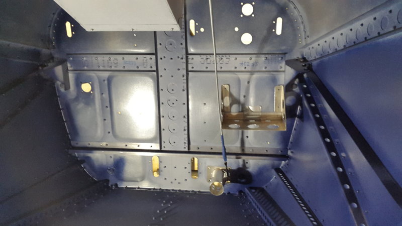

- made holders for the MGL sensors and the LiFePo Batterie to go on the firewall
- found a nice place for the headset panel

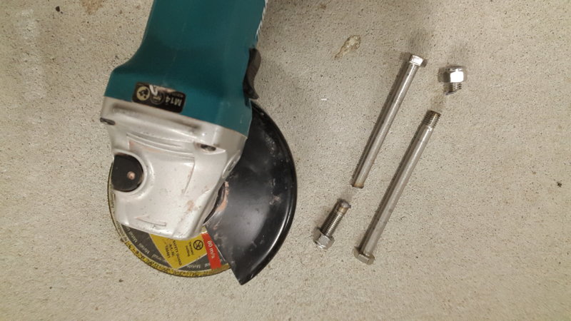

Big problems caused the M8 x 120mm A2 bolts. They hade to be removed.

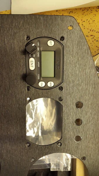

Also ordered TRIG Transponder and Com

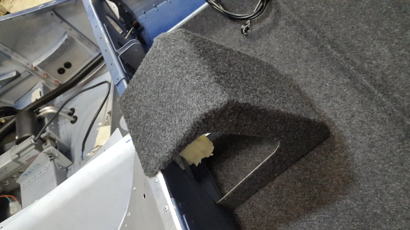

Are the chart holders the ICP option or did you make them up yourself?
  Quote
Its an ICP option , even i have them =)
The bolts where of cheap making. Stainless steel can cold weld. Sorry bad english.
First, when I tried to remove one nut, it got heavier to move instead of leasier. So I changed them all. None of the nuts came of the natural way. Friend of mine had the same problems.
The card holders are lightweight.

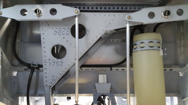

spend much time with the fuel lines... included some of Marks modifications

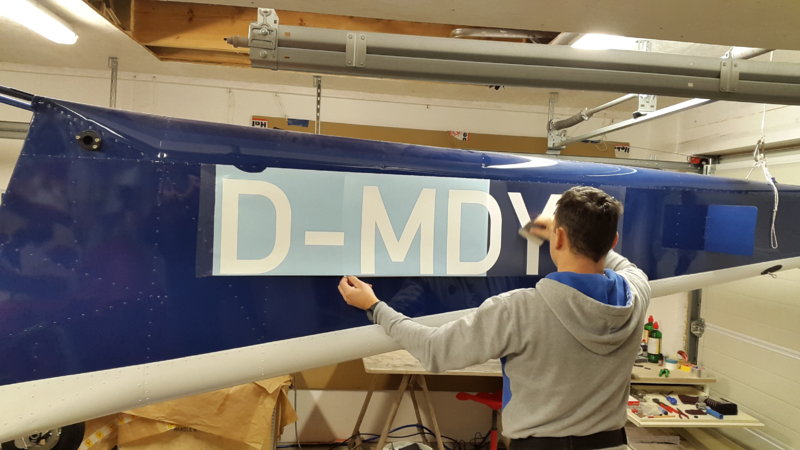

my friend put the ID on, he did a great job
made holders for the LiFePo battery, the MGL sensors and the transponder / Com

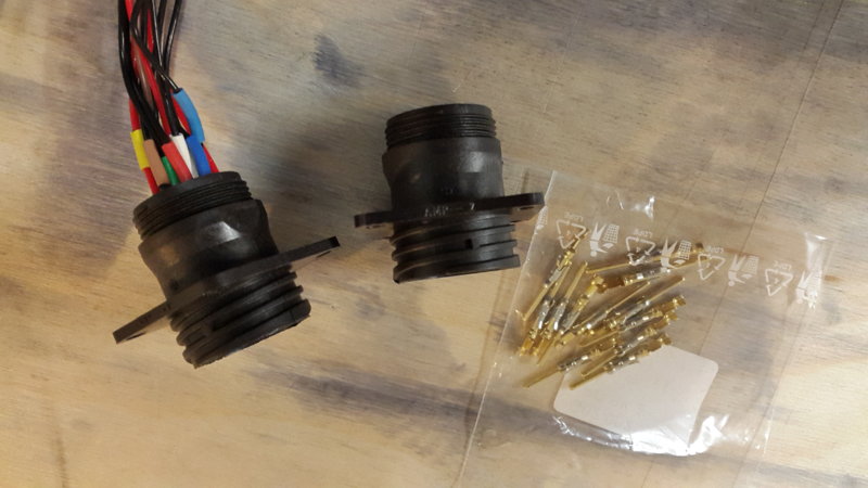

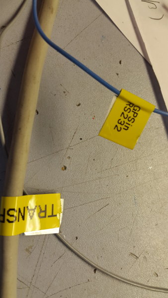

ordered tons of cables and connectors for thge TRIG and MGL stuff

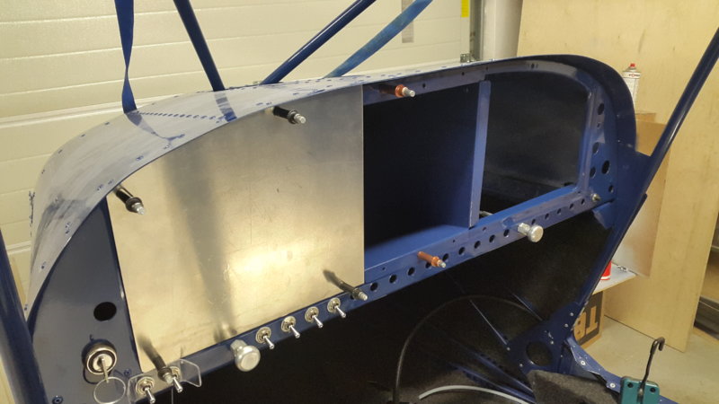

Some things not decided:

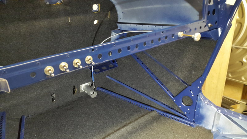

- I would rather have an engine start knob
- Why not put the MCFallane trottle a little lower at the panel? The original position seems quite high. Are you comfortable in you birds?
I find the throttle position for the pilot quite comfortable now in the XL. When I put the McFarlane in Mabel it will go roughly in the same position

Thanks Mark. So you are o.k. with the position. After seeing some videos, I was just thinking the position seems uncompy high. so maybe switch the position of ignition key and trottle.
Any other hints gerarding ergonomics?
Well I am 186cm tall so its not high for me :)
But I really have had no issue at all where it is. I like it as I use my finger to adjust the trim while my hand is on the throttle but on Mable that will be different as I have a Ray Allen joystick head with the trim buttons on it

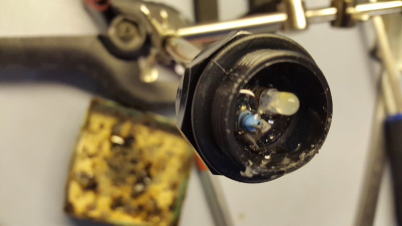

I changed out the idiot bulb in the fuel sump warning to a 10mm flashing LED it was easy to do I think I did post stuff on it in the blog. As far as other layout of parts nothing really extra. Maybe the ignition module switches I do have close to my choke knob which makes it easy to hold the choke open and I can reach with my fingers to get to the ignition switches. I start on 1 switch then flick the other on when it starts and when I shut down I also do 1 switch then the other. It allows me to test each module on start as I alternate which one I start on and when shutting down I also alternate as this can pick up a crook module as well and the engine stops much better.

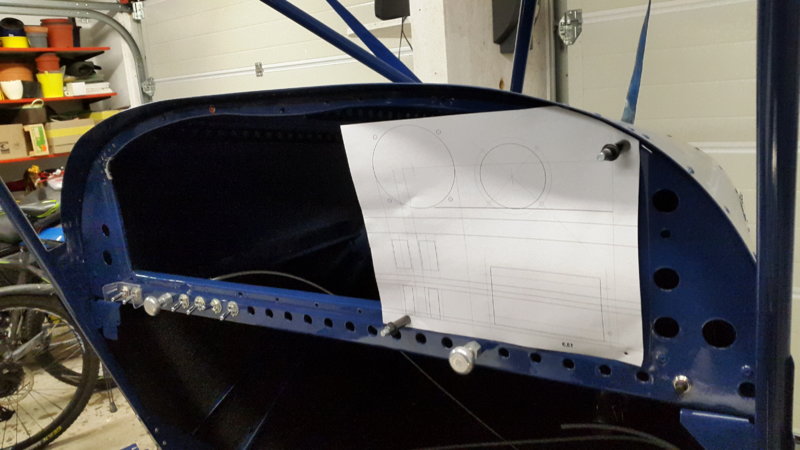

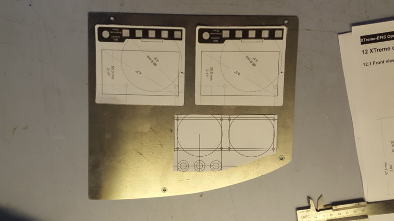

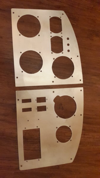

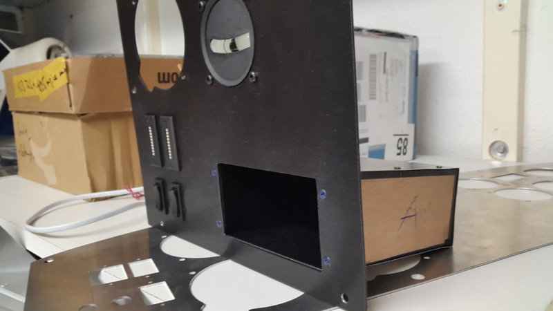

Hey Savannah builders,
X-Mas is a great time for building.
I'm in the middle of wiring all that fancy electronic stuff together. This is a lot of fun but an absolut time-eater.

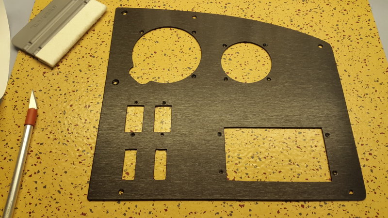

But all is going well. Even cutting my coustum panel-halfes with a tiny handsaw (intended for ply wood) worked out perfect.
What gives me headakes is the MGL RDAC. It has 1000 inputs for thermocouples but very few for Rotax sensors....
