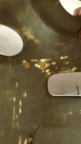

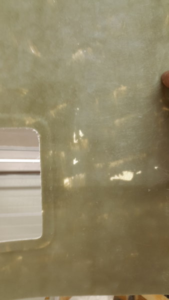

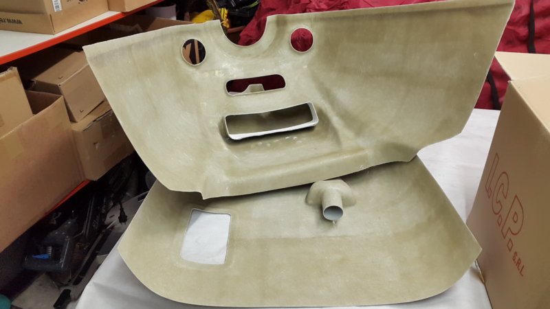

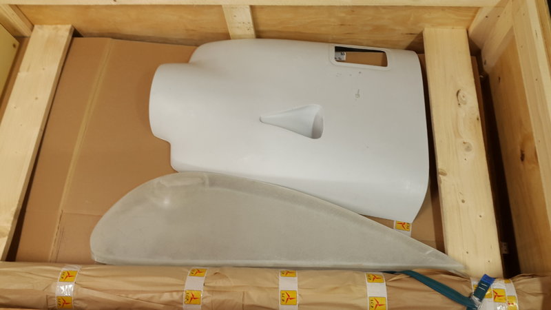

Indeed...and there seems to be some sort of primer/sealant/coating? on the fibreglass cowlings that we didn't get.And what's this about flush fuel caps???
Looks like they have gone back to the Gel Coat fiberglass finish. Embarrassed as I am to admit it, my unfinished kit had that in mid 2013, The raw finish causes some more headaches to achieve a smooth finish to paint but saves a little weight.
Okay...yes, I know of a builder here who is 'enjoying' an involuntary education in bunging up ICP fibreglass...
Hmm...there's also some sort of port or duct (?) in the upper cowling that I don't recognise...

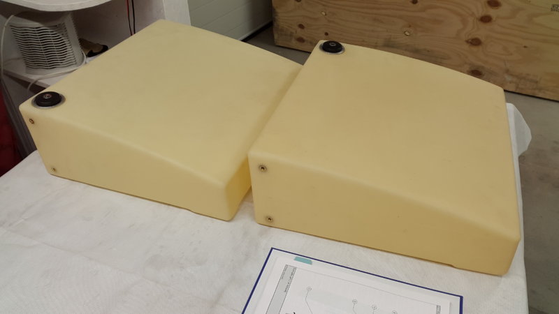

What is this talk about flush tank covers? The don't seam very flush to me? Flush means nothing sticks out, right? Or was this ironic and I failed to grasp it?
Well, they look very flush compared with what we've got, hence the comments...and the new-kit-voyeurism....)
Wait, I have a picture of the cowling.

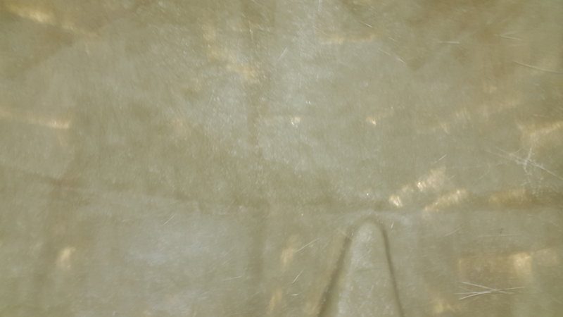

My fist impression on the fiberglass parts where not the best. I don't want to complain (at least not to much). But when you are used to hightech, seamless, finished out of the mould RC-plane fuselages, you feel like 1960 seeing the parts in the box. The materials are the cheapest you can get. And the work seams a little unskilled or unmotivated. Could explain further, but lack the vocabulay. It is a little like the cleco pliers, which don't fit to the rest of the excelent crafted aluminium parts.
You are right. Just checked it. I had to put the words into google and got pictures of motorcycle tank covers.... sorry my fault.

The "duct" on the upper cowling is standard to take the air into the air box. The amateur fiberglass parts look much better after a sanding, it is itchy stuff to sand and wear a respirator to keep the glass out of your lungs.
Your Gel coat is much more amateur than mine was, it will definitely need more than just sanding to make it ready to paint. Your wing tips are the same finish that the cowling was delivered in for some time previously.

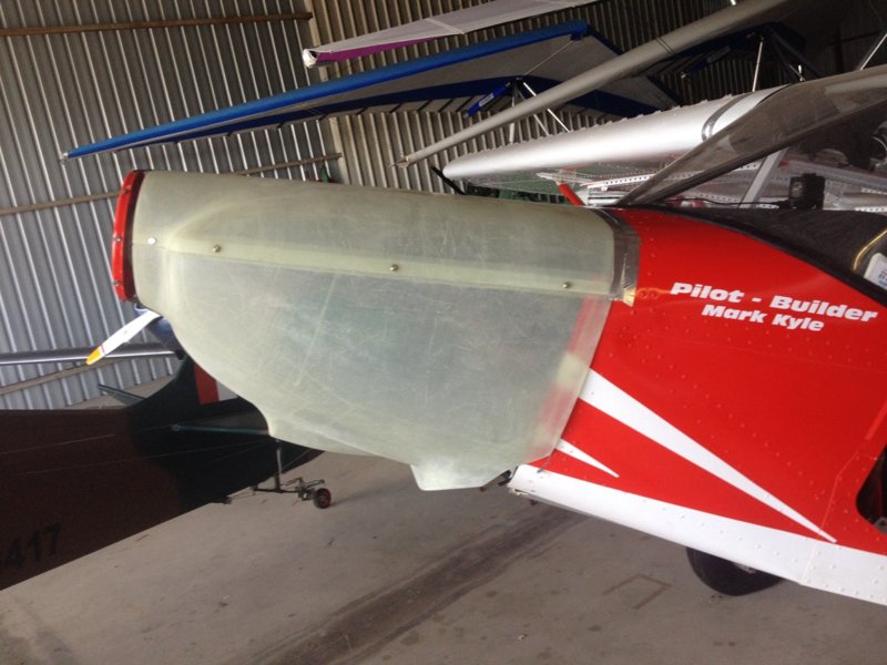

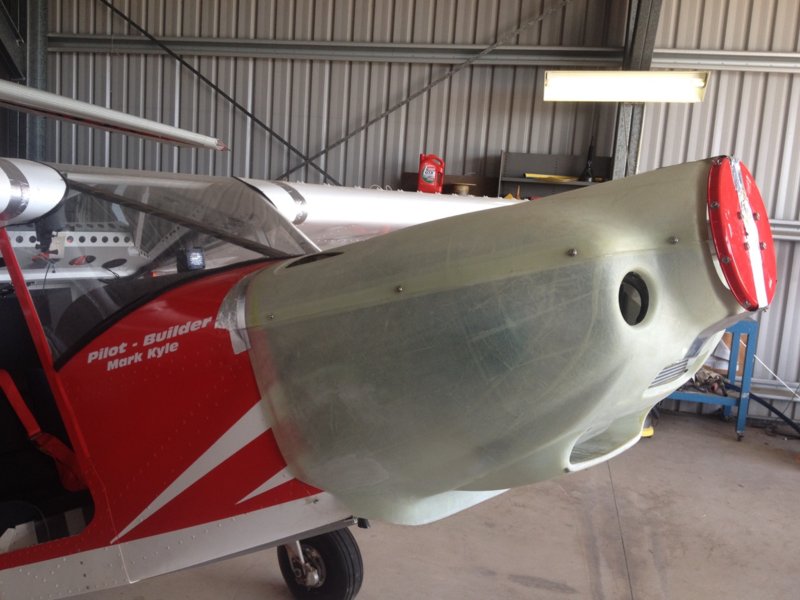

Ladies and Gents. I have a question. We recently began fitting our upper and lower cowl halves. At 2cm between spinner back plate my cowl just barely fits under the skin on top. Also, the air scoop rubs my left carb at about the 1 o'clock position looking from the side. Any tips would be appreciated. I know of no other Savannah to have that issue. I'm worried to bring the cowl farther aft to clear the carb would cause a much larger gap between cowl and spinner. Any tips or suggestions would be appreciated.
Jim
Quite a lot of us have mounted the cowls externally not like how ICP does it. Its a bit of a jiggle but it can be done. I did have to shave a little off my top cowl to stip the carb rubbing and also had to pull the radiator back a bit. Also you need to cut a hole either side of the cowl for the exhaust pipes or the cowl will blister

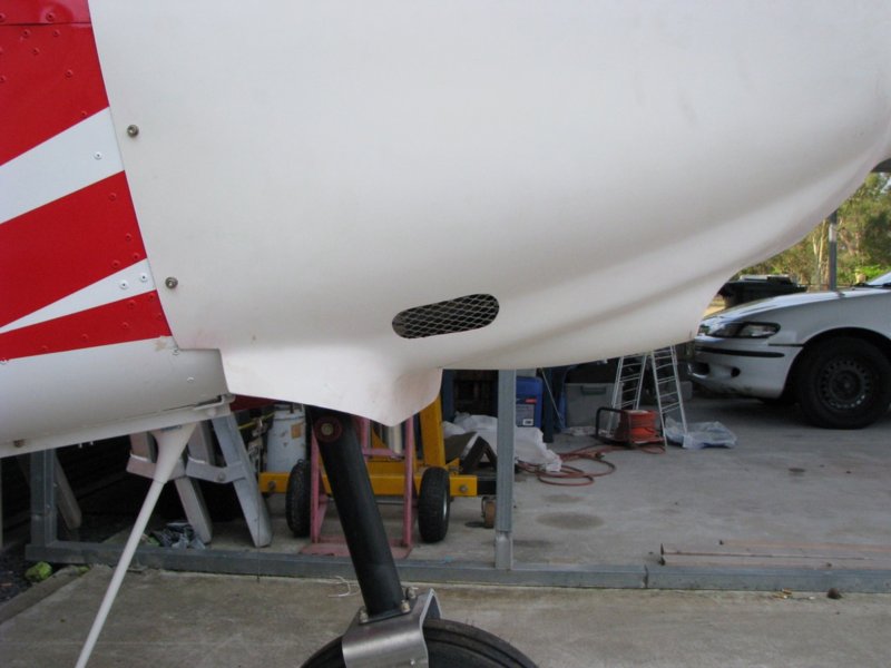

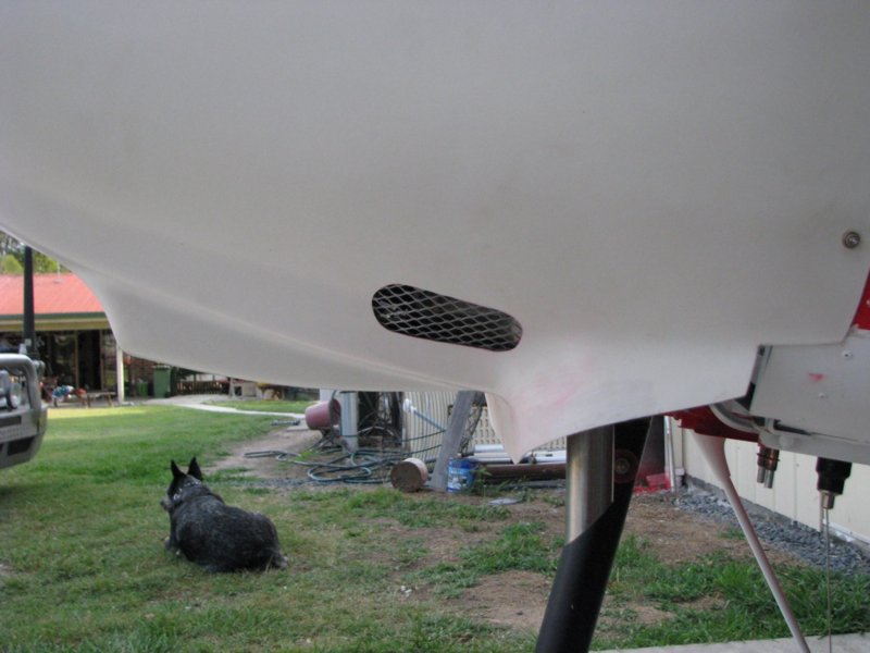

Ok the all completed pic is when I took the plane for its first flight. The other pics are when I had to replace the cowl after the dreaded noseleg incident. Is the only weak point of the Sav. A lot of people have ripped off the noseleg so much so the local agent here keeps heaps of spares for the parts required to repair it
