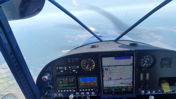

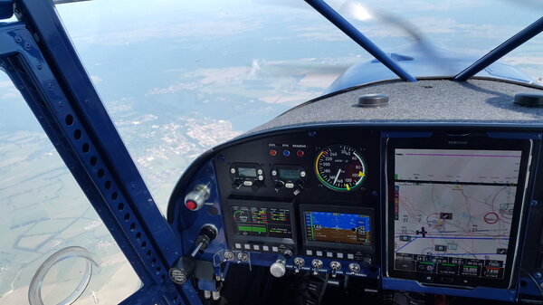

Could you post a picture of the complete dash panel?
Hope you will 80knots...
Panel has Trig radio + transponder and a nice Samsung Galaxy Tab S2 running EasyVFR
