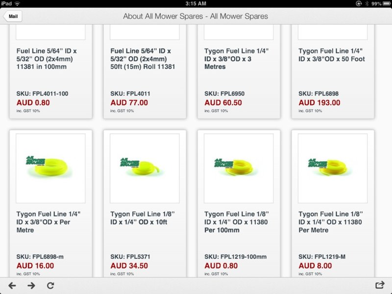

Nman Posted February 18, 2017 Posted February 18, 2017 G'day Geoff If you use the second link that Soleair provided: search the site for Tygon They have 1/4" ID listed. Cheers Norm
geoffreywh Posted February 19, 2017 Author Posted February 19, 2017 Fantastic. although $20 per meter is over twice the US cost. The convienience may be worth it. Thanks..G
