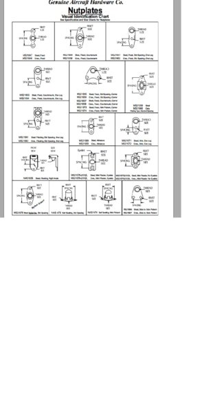

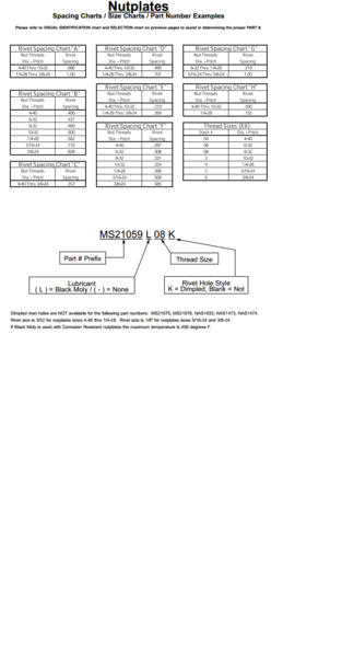

Marty_d Posted February 15, 2017 Posted February 15, 2017 Hey all, Starting work on the lower rear fuselage of the 701 and realise I need nutplates for the rear access hatch (and other inspection panels in wings). Don't really want to do an order to the US because the freight would be far more than the item cost. Is there anywhere in Aus that sells these? I'd need about 50 of the plates and screws. Part numbers are: Plates: MS107SL3 Screws: AN525-10R7 Also #40 blind rivets, not sure if these have to be anything special as the nut and plate would be taking all the load. Thanks! Cheers, Marty

old man emu Posted February 15, 2017 Posted February 15, 2017 I think that you have mis-quoted the nutplate part number. I think it should be MS21075L3. Give Dave Dent at QED Aircraft Parts and Hardware (02 464551514) a call. Do you have a part identifier for the blind rivet? Dave should have those also - as well as the screws. 1
Marty_d Posted February 16, 2017 Author Posted February 16, 2017 Thanks OME. You are correct, I stuffed up the reference, it is indeed MS21075L3. I took it off the photo building guide instead of the plans and it was wrong there. Just gave Dave Dent a ring and he's getting back to me with a quote.
