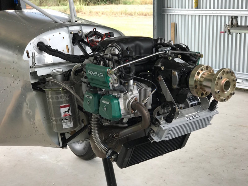

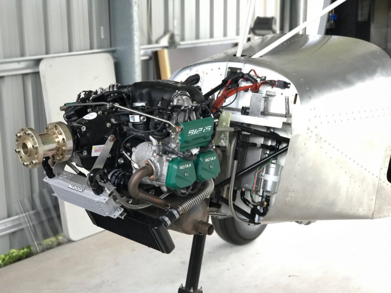

Did it fit in the supplied ring mount or did you have to come up with a different mount? How much will you need to butcher the cowling?
The iS came on its own ring mount already fitted, which was identical to the supplied one in the kit, except it had 11mm holes that the mounting bolts went through. I had an engineering shop make some sleeves to suit, which cost a carton of beer.

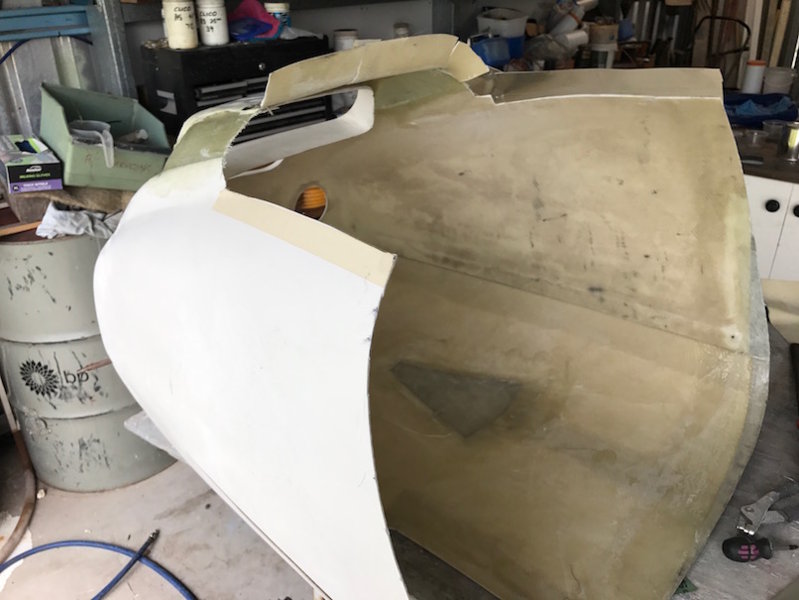

As for the cowlings, a fair bit. Mostly due to the exhaust. Top cowling is straight forward, remove air intake scoop and fibreglass. Bottom cowling required shifting the bottom cutout forward to accomodate the muffler. Also a bit of cutting/widening around the scoop for the radiator, as it sits differently due to the exhaust.

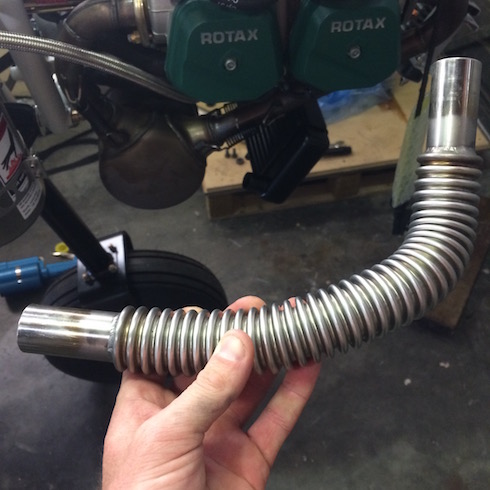

Also made up some stainless radiator hoses, because I was concerned about how close the exhaust pipes would be to rubber hoses
Nice looking engine and setup.
Noticed the radiator pipes straight away. Being metal, I'm wondering if they will draw heat into the coolant from the exhaust?

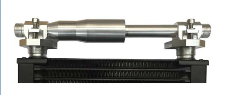

Awsome looking oil cooler there too!!! I spotted the MOCAL sticker. They have some nice stuff on their site.....Do they (the injected rotax) come with an oil thermostat as standard?

I couldn't imagine much heat being drawn in. The exhaust pipes sit a little wider than the uls engine. So the pipes sit close just where the coolent inlet/outlet is to the radiator. Plenty of air flow around the rest.
The oil cooler is standard, but doesn't come with a oil thermostat. Although I did consider one as per attached pic. Thought these were a great design, simple and less hoses
Any particular reason you decided against an oil thermostat?
I'm not against an oil thermostat, I think I might even end up putting one on there eventually. Keeping the oil at optimum temp can only mean good things for engine life and performance.
I'll see how I go with the silver tape first. Would be good to know people's experiences with oil thermostats.
And yes, you would think for all those dollars they would include it with the engine :)
I did a lot of research into oil thermostats on 912 and most people who put one on found little or no benefit. So I decided not to bother putting one in myself. Then had a guy ask me to install one for him. I told him about my research but he insisted so I installed one for him and yes indeed made little or no difference to warm up time.

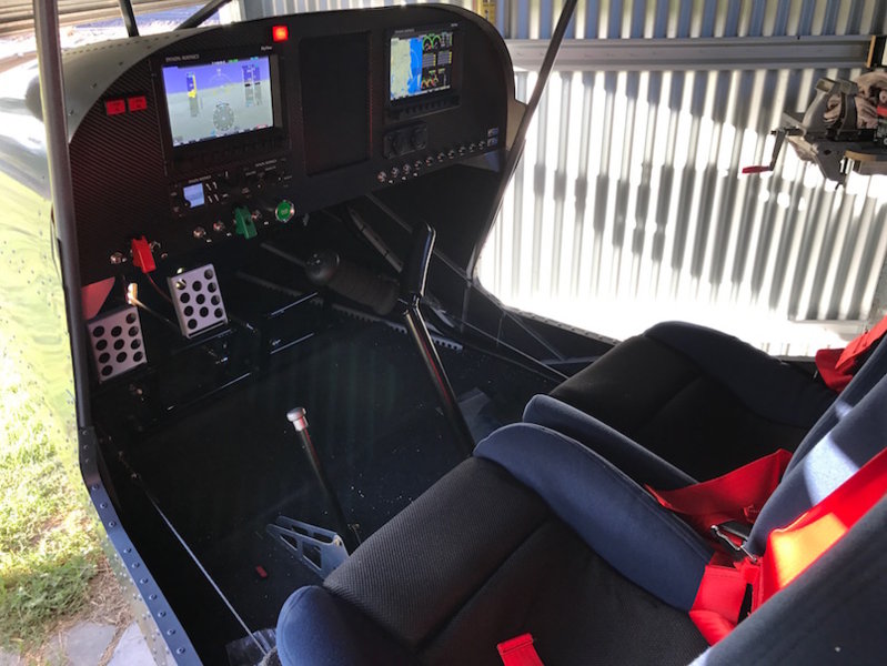

Yeah I think if your going with the iS, you would go with the electronic dash. Its pretty much just 2 wires from the ECU to the EMS module, so you get things like voice alerts as soon as you exceed parameters, throttle position indication for easier starts, rich/lean mode, and adaptive gauges for the tachometer with regards to oil temp, fuel computer etc. Pretty handy that the iS comes with all these engine sensors built in too.
