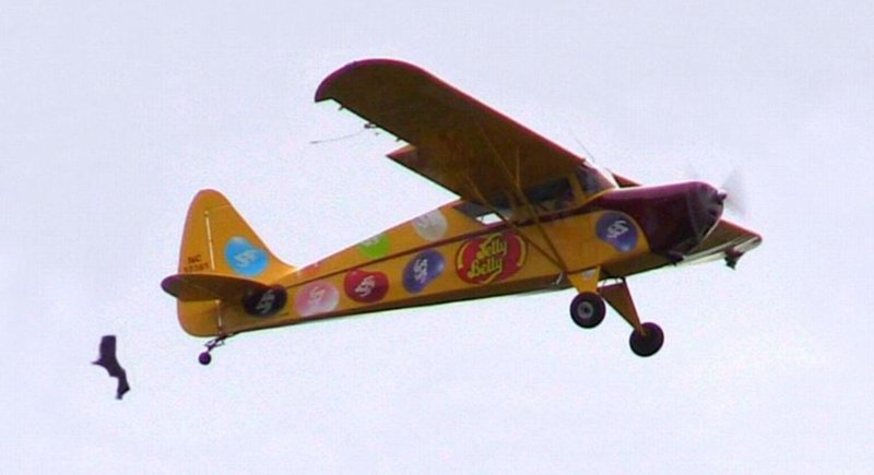

bexrbetter Posted March 13, 2017 Posted March 13, 2017 Quote Do you mean like this? Probably the best scenario, control surface gone rather than interfering with control and has redundancy.

Jaba-who Posted March 13, 2017 Posted March 13, 2017 Quote Do you mean like this?[ATTACH=full]49291[/ATTACH] I saw this guy doing this act in Oshkosh and he lost progressively more and more bits. Unfortunately I can't remember which bits but it was quite a lot. 1
