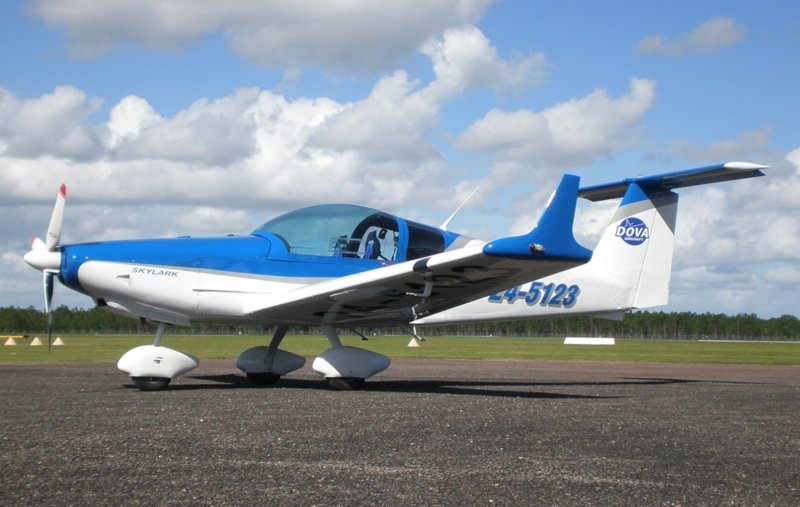

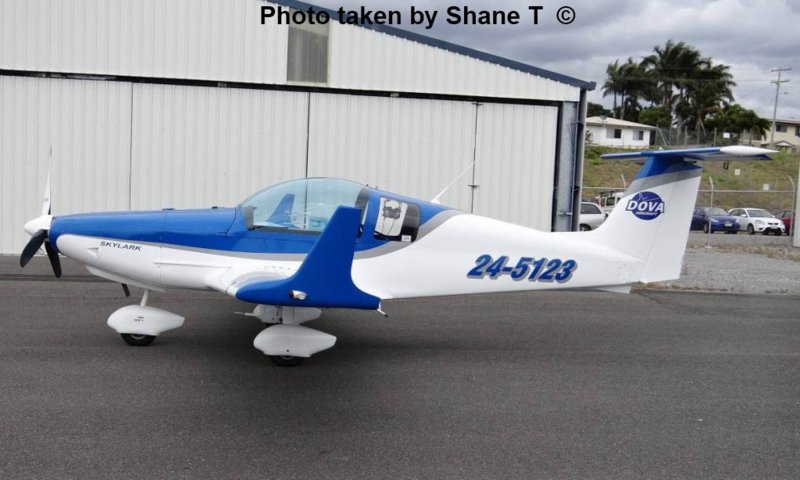

FlyV I am going to have to convince the wife that we need your turboprop & a 5 bladed prop for our Skylark, that long nose is just begging for a couple of turbine exhausts hanging out!
