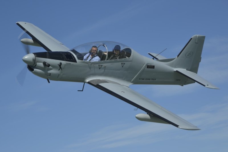

flyvulcan Posted December 19, 2017 Author Posted December 19, 2017 I can't see one working without a CS prop. When you go down that road you might as well be going fast or you are wasting the technology. The plane should be 150 knots Plus. nev Funnily enough, we have had a lot of interest from the low and slow community. Mainly from the perspective of short field take-off and landings. The light weight of the engine combined with the constant speed prop offering both static and dynamic thrust, as well as the potential for beta operations has some of the Cub type manufacturers interested. Sure, their loiter fuel flow wont be good but those dirt strips, river sandbars etc. may become that little bit more accessible. BTW, the engine will only come with a CS prop that is fully controlled by the ECU. We intend to offer a selection of gearbox ratios in order to allow different sized props swinging at different speeds. The prop rpm will be set to match the reduction gear ratio optimum output speed so that again, the single lever throttle control will simply be a more power/less power, go faster/go slower, climb faster/climb slower scenario for the pilot. 2
flyvulcan Posted December 19, 2017 Author Posted December 19, 2017 A scaled down pc-12 with the 200hp version would be good too while we are putting in requests.... It will likely go in one of these as we have a great relationship with the manufacturer: If you want one, they are available in Australia. See The Flying Legend | Your new aircraft or PM the user Tucano on this site. I'm sure he'd be happy to hear from you! Dave 2 1
