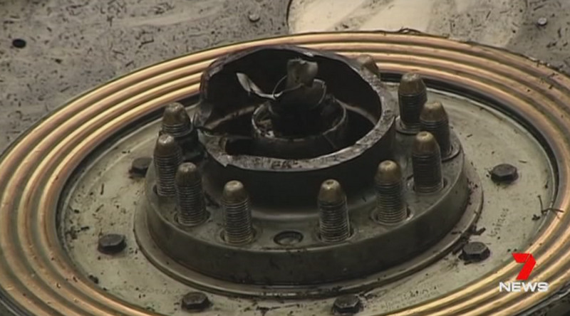

David2ayo Posted March 22, 2017 Posted March 22, 2017 ABC News online has story and good pics of prop - with the Dowty label on it! Lots of studs with no nuts - a bit interesting.

dutchroll Posted March 22, 2017 Posted March 22, 2017 Looks like there's one nut still on the stud holding the prop flange on? Bit hard to tell from the photo whether the threads on the others have been stripped or not. That's a puzzling photo actually.
Sloper Posted March 22, 2017 Posted March 22, 2017 Goodaye all Looking at the pic and the nuts missing makes me think they where not fixed propley and spun off causing the prop to wobble on the shaft, cause it to crack and off she goes. Loss of nuts in any instance is bad. regards Bruce
Bats Posted March 22, 2017 Posted March 22, 2017 Dutchroll, here is another, I note that there appear to be a couple of washers on the opposite side to the apparent nut. I wonder if the photo isn't a bit of a red herring, with the ATSB being part way through removing the flange when the journos stuck their oar in? The flange was certainly missing when the prop was photographed before being loaded onto the truck.

dutchroll Posted March 22, 2017 Posted March 22, 2017 Dutchroll, here is another, I note that there appear to be a couple of washers on the opposite side to the apparent nut. I wonder if the photo isn't a bit of a red herring, with the ATSB being part way through removing the flange when the journos stuck their oar in? The flange was certainly missing when the prop was photographed before being loaded onto the truck.[ATTACH=full]49502[/ATTACH] Yeah I wondered that too, but I'm puzzled as to why they would start disassembling the prime piece of evidence before moving it into a hangar and doing it properly. It's not going to make the investigation proceed any quicker and all it would do is risk dropping bits of evidence into muddy grass. And why are there at least two washers left on? Surely you'd do nut, washer, nut, washer, etc, bagging them as you go. Also why would you allow journos in for photographs while you were in the middle of removing this vital evidence? I'm confused...... I noticed a bank of brushes on the disabled engine, and now a bank of slip rings on the underside of the spinner backing plate. Having a Airmaster constant speed prop, I just accepted that it was electrically controlled pitch. Don't forget propellers on larger aircraft are electrically de-iced. The blades at least, and often the spinner too. 1 1 1
David2ayo Posted March 22, 2017 Posted March 22, 2017 Yeah I wondered that too, but I'm puzzled as to why they would start disassembling the prime piece of evidence before moving it into a hangar and doing it properly. It's not going to make the investigation proceed any quicker and all it would do is risk dropping bits of evidence into muddy grass.And why are there at least two washers left on? Surely you'd do nut, washer, nut, washer, etc, bagging them as you go. Also why would you allow journos in for photographs while you were in the middle of removing this vital evidence? I'm confused...... Don't forget propellers on larger aircraft are electrically de-iced. The blades at least, and often the spinner too. Suspect the reason the flange was removed is that it is the most important piece of evidence, and they (whoever "they" are) didn't want it hanging under a helicopter. Why it was photographed at various stages, who knows, it really doesn't matter. Interesting to compare ABC and Seven news - suspect ABC were a bit later arriving. Note the prop landed with drive flange down, and was turned over before liftoff. Assume they were taking video / pics while this was happening, would be very embarrassing if it all fell to bits as it was moved! David 1
spacesailor Posted March 23, 2017 Posted March 23, 2017 What is the hole (missing bolt!) in the pic spacesailor
