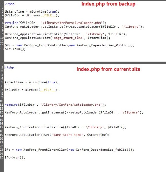

Admin Posted March 19, 2017 Posted March 19, 2017 Today (Sun 19/3) at approx 7.00 in the morning I did a full backup and download of the site and its databases. Then at approx 8.00am I was advised by a user that the site may have been hacked. I did a quick check on the site and saw that a core file had today's date on it which it shouldn't have. Looking in the file and comparing it to the file in the backup I saw that whilst they had exactly the same code, the correct code, the one on the server had line spaces in between the lines of code which didn't add up i.e. why was there extra line breaks in the file compared to the one that I had backed up plus the backup had the correct file date of late last year...something isn't right. I did a complete scan of my own PC and it was clean so I closed the site whilst an extensive scan and analysis was done by the company that provides our own dedicated server, not just my server but all other servers. This took several hours to do and in the end it was decided to just delete the site, its server account, the server software, reinstall it all with new passwords, and then upload the backups I did first thing this morning which again took some time. This however will mean that a few posts i.e. any posts made first thing this morning, will be gone but I believe that there were only a handful anyway. I am very sorry for this. We have extremely strict security here and looking at the logs the so and so was only on for a very very short time but was kicked out, not enough time to break through the site to database connection security and get any info from the database. Even if someone did all passwords are protected by 1 way encryption. This means that the database only stores jumbled up letters and numbers and can't be reconstructed. I can't even tell what a user's password is. If you are using the shop and paying by credit card you are transferred out of Recreational Flying into Westpac's own server so I or the site has no way of knowing what your credit card details are...again another security feature I use here unlike other stores that store your credit card details. All in all, it has been a very long and hard day just to be on the safe side. In a couple of days I will be implementing Secured Socket Layers, an SSL certificate that encrypts the data between your PC and the site as well, adding an even extra layer of security however it requires a lot of work to the site to change from http to https. Please be assured that all is ok and again please accept my apology for this happening. 2 1 4

Admin Posted March 19, 2017 Author Posted March 19, 2017 They never got a chance to get anywhere but I got the server software reinstalled, changed all passwords and reinstalled the site and database just to be on the safe side
Admin Posted March 19, 2017 Author Posted March 19, 2017 The ability to add new attachments to posts has now been fixed The Tutorials have now also been restored. As they are all html files that haven't changed recently I have uploaded the files from a backup done late last year so they should also be clean I still have to do the shop but I am just to exhausted today so I will do that tomorrow morning besides I have to go through every single file, delete all caches and check every image
Admin Posted March 19, 2017 Author Posted March 19, 2017 For the tech savvy, the attached image shows the difference I picked up in one of the core files...you can see the code is exactly the same however it wasn't the same as the file that I had just previously backed up

Birdseye Posted March 19, 2017 Posted March 19, 2017 For the tech savvy, the attached image shows the difference I picked up in one of the core files...you can see the code is exactly the same however it wasn't the same as the file that I had just previously backed up[ATTACH=full]49403[/ATTACH] Any chance that there is text in those lines you cannot see i.e. its white on white to prevent viewing? I've acquired and used similar techniques for other reasons in the past ;-)
Admin Posted March 19, 2017 Author Posted March 19, 2017 Any chance that there is text in those lines you cannot see i.e. its white on white to prevent viewing? I've acquired and used similar techniques for other reasons in the past ;-) Good thought but no as it is just plain text
red750 Posted March 19, 2017 Posted March 19, 2017 If there was additional text, the file sizes would be different.
