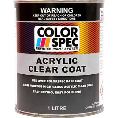

SDQDI Posted March 30, 2017 Posted March 30, 2017 That all seems like hard work if you ask me. I think the easiest way would be to paint over the paint with something like this That would solve all your problems as your windscreen would then end up clear, we used this technique at home recently, we had a green wall and were not happy and wanted it blue so instead of stripping the old paint we just painted over it with a blue paint and viola we got a blue wall with hardly any effort. 1 9 1
