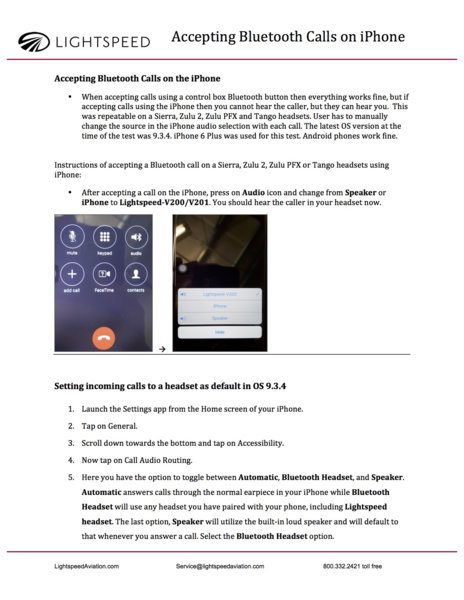

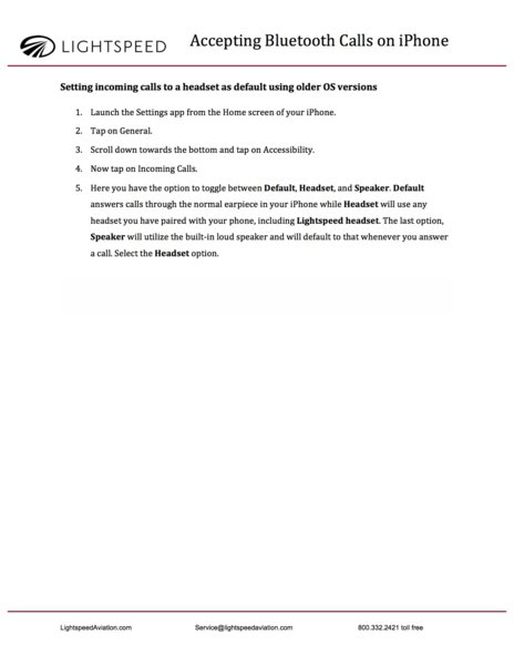

Kyle Communications Posted April 5, 2017 Posted April 5, 2017 Look at this..when using on a later iphone you need to change the settings in accessability
