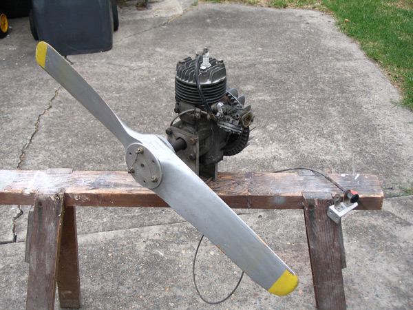

Guest ozzie Posted November 28, 2007 Posted November 28, 2007 would anyone from the "good ol days" happen to remember the diameter and pitch that was used on the Victa 160cc direct drive engines. maybe someone may have a prop and hub laying around? thanks ozzie

Guest ozzie Posted December 3, 2007 Posted December 3, 2007 Maybe it is the briggs and stratton that don't have the bearings. Be handy if i could fond cliff van pragg as he played with a few victas. that photo looks like the same model i have to rebuild. what pumper carb model is on it? Ozzie
