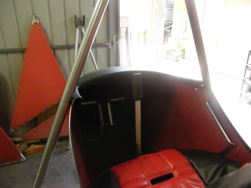

Hi KR. I notice the your control stick is in touch with the leading edge of the seats. Did you have to cut away any of the under-lying frame etc, to get full stick movement? With my rally seat conversion in my Thruster, I've had to cut away the seat AND modify the stick. I still haven't got it right and might have to modify my seat cover as well.
To get full up-elevator, I did, yes. I removed a 6" x 6" cube from the front-centre of the seat cushion - you can kinda-sorta see the depression left behind. I took the cushions to an auto upholsterer for him to cut the fabric out around that and marry it up around the cutout so it gives it more of a production look. I should have them back in a couple of weeks, and hopefully, I'll have the registration transfer from RAAus to CAsA finalised by then so can actually make use of them!
Thought so/. Did the same to mine today. Plus, the seat is double skinned so I cut away a wide groove in the bottom skin so that I could get it to sit lower. I'll do the mods to the cover myself. I'm fairly handy with a sewing machine. Made me first wife's maternity wear, my kids dresses and my second wife's wedding dress. I'm not just a pretty face ya'no.
