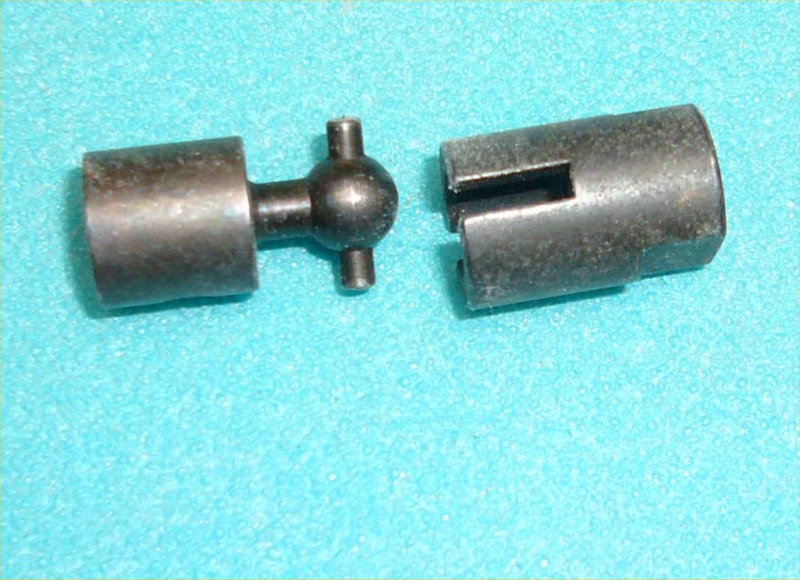

There are numerous means of having auto-connect/disconnect controls which cannot, under any normal circumstances, come undone. They don't employ loose nuts or whatever you have in mind. For one easily researched example have a look at the paddle system that is used for Sonex to fold their wings. My own project uses a 'dog-bone and socket' system (imagine a tube with a slot cut into the end of it and the mating half is a rod with a cross-pin), controls lightly sprung to centre when disconnected they must engage when the wings are unfolded and there is nothing to come loose, in fact all parts on each side are welded together ...

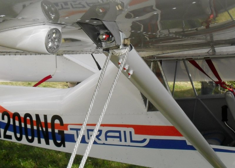

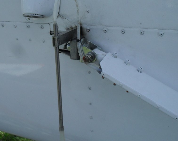

The only thing that concerned me a little (and I can't remember if I mentioned this before, or just refrained), but I was a little worried about the top end wing/strut attach point..
Most aircraft set the attach systems up to use bolts in shear, as does the Trail for most of the wing, except the top of the strut.
To facilitate the folding system, a bolt is used in tension, and it is used through two diaphragms (technically).
It's OK if this is done with a complete 'overkill' of materials and hardware, but from memory, it just looked like a 3/8th bolt through two pieces of 1/8th plate just under an inch square, welded to support brackets.
Probably well strong enough, just left me a little concerned.

Hi Pylon,
Yes I think you mentioned the diaphragms/bolt-in-tension thing. As you say, it's probably well strong enough though it doesn't look ideal.
The bolt-in-tension aspect is fine, in fact bolts seem to be used in shear mostly on aircraft and similar structures, but they actually have a higher rating in tension than in shear. These days my day job is in structural steel and whenever lifting lugs are attached to anything the bolts are always arranged in tension, so I'd say that's probably the best way to go about it even if it doesn't 'feel' quite right. The benefit of using bolts in shear for aeroplane struts is that it provides a good start for adjusting/setting dihedral and other wing rigging.

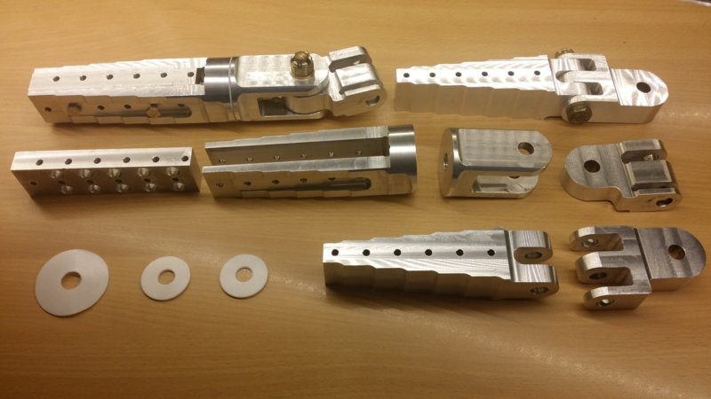

Down the track I'd expect that Groppo might develop machined parts for their top strut fitting, rather than fabricating them, for better looks and structural consistency if nothing else, and especially if it makes the customers happy ... My DooMaw has wings that fold similarly, except they hinge at the rear spar for a less tall folded package (though it has the penalty of being longer), so I also needed a 'wrist' mechanism at the top of the strut. I machined mine from 6061T6 billet. As a one-off set it was quite a time-consuming business but for a production aircraft kit using a multi-axis CNC milling machine it would probably be a lot quicker than fabricating them.

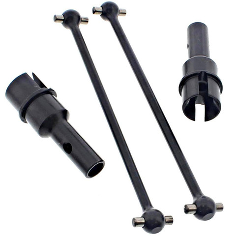

Pic of my strut fittings, also the second and third pics show a 'dogbone' arrangement, one of many ways to have auto-connect controls -
