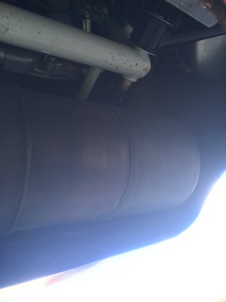

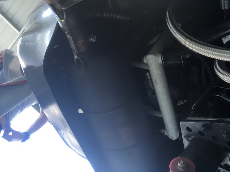

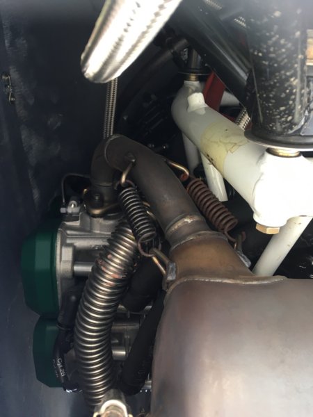

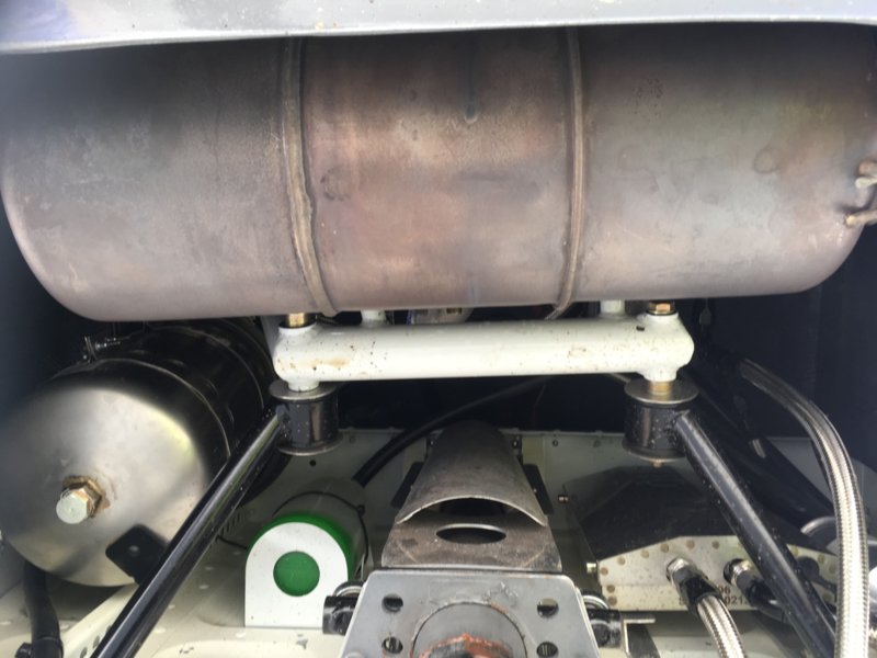

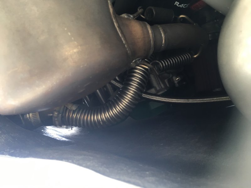

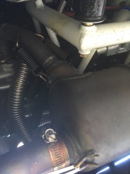

There is a new Sav owner at my airfield he has a 912IS fitted and it uses a std rotax muffler BUT the welded ends on the muffler outputs are different to allow a angled entry this means you can keep the std size Rotax muffler and not have to fit a extra piece in it
like I had to do. I took a couple of pictures of Lee's 912IS muffler install when I saw it.
So if you were going to spend the bucks you would order a 912IS muffler and pipe setup to suit the Sav and you will then need to modify your cowl
