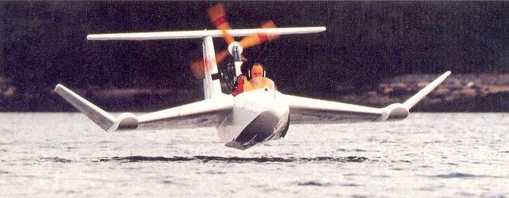

Blackhawk Posted June 2, 2017 Posted June 2, 2017 This is a curiosity question and one that will receive a lot of debate. [LOL] At what height do you need to have a pilots license to operate an airborne above ground vehicle. A recreational Wing in Ground Effect craft does not require a pilots license but you do need a boat license and these craft can travel up 30 meters above the ground/water. So if you were operating a vehicle that would not reach a height of 30 meters that may or may not be classed as a WIG craft and was not operated over water would you need a pilots license or could a motor vehicle license be enough??
storchy neil Posted June 2, 2017 Posted June 2, 2017 that is flight so pilots lic needed boat lic also required neil 1

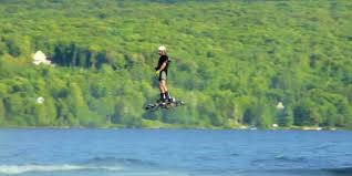

Blackhawk Posted June 2, 2017 Author Posted June 2, 2017 And what about this that flies about 5 meters above ground.

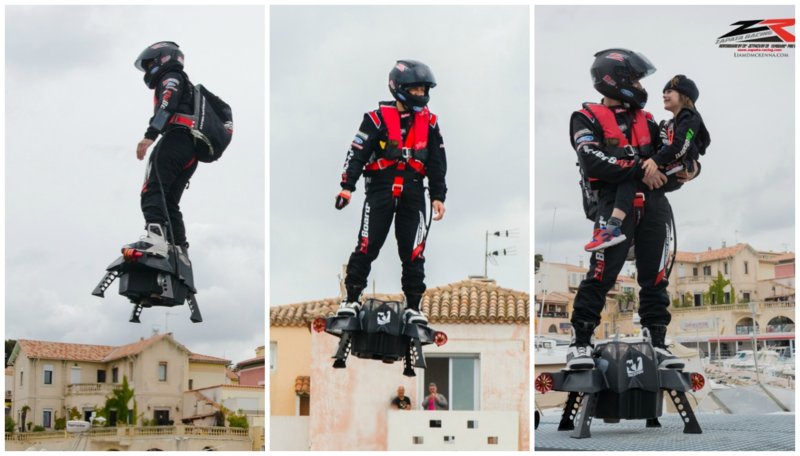

Blackhawk Posted June 2, 2017 Author Posted June 2, 2017 Or this, he holds the world record for the longest flight
Nightmare Posted June 2, 2017 Posted June 2, 2017 Well, unless you're coming in to land or taking off, unless you have a low level flying endorsement, the minimum legal height I can fly at on my certificate is 500' over rural or water or 1000' over built up areas. If I had a seaplane (hull) endorsement could I fly that aircraft? I think the altitude would be the issue. Maybe I could pass them off as "Strip Runs"??

Oscar Posted June 3, 2017 Posted June 3, 2017 From memory, if it can't operate out of ground effect, it's an ICAO 'Class A', and it's a boat. If it exceeds the 'low-speed' limit for watercraft licences, then you would need a 'speedboat' ( or whatever that may be) licence in your State or Territory. If it normally operates in ground effect but can 'Jump' - but not above 500 feet AGL ( or AWL, I guess), then by ICAO terms it is 'Class B' and remains a 'boat'. I don't believe this has been 'tested' in any Australian jurisdiction. As far as I know, CASA doesn't have any interest in things that can only 'fly' below 500 feet, (particularly over water.) With all due respect, unless you restricted your flying to places like the Simpson Desert or Lake Eyre, a WIG is not a safe option. If it can sustain operation above 500 feet AGL/AWL, then it is an ICAO 'Class 'C', and an aircraft. Technically, then you require VH-reg. and I would guess, at least an RPL. I don't believe there is any ASTM classification for this, so LSA and a Recreational Pilot's Certificate probably would not cut it.
